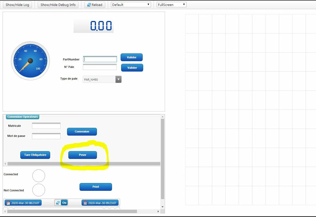

Hello Everybody
I'm trying to get weight data from a scale that I connected to a network few weeks ago and I want to know if it is possible to communicate with the scale using a TCP-IP socket connection by using only thingworx.
I recently knew recently that kepware could help for this operation and it could be more efficient but unfortunately we have a licence probleme so I need to use only thingworx.
More details about the scale :
The scale is a Mettler Toledo Viper, IP adress : 10.18.200.51    and     Port: 9761
to get the weight from the scale we should send a request called "SI" and then we get an answer like ***SS**258**g
The communication should enable me to extract the weight and display it on a mashup by clicking a button "Peser"
Thank you in advance for you Help

Ziyad1-VisitorAuthor
March 30, 2020
Thank you Constantine for you answers and recommandations
Actually I did the difficult part in java by using sockets and I've got the weighted value from the scale, here is the code that I tested
import java.io.*;
import java.net.Socket;
public class Connexion {
public static void main(String[] args) {
//Connection parameters // Numéro de port + adress du host
String hostname = "10.18.200.51"; //todo: Modify to match your device's address!
int port = 9761;
System.out.println("Connecting to " + hostname + ":" + port);
try (Socket socket = new Socket(hostname,port)) {
try (BufferedReader in = new BufferedReader(new InputStreamReader(socket.getInputStream()));
PrintWriter out = new PrintWriter(new BufferedWriter(new OutputStreamWriter(socket.getOutputStream())), true))
out.println("Connected!");
try {
for (int i = 0; i < 10; i++) {
out.println("SI"); // Request weight IP = Immediate Print
out.println("Envoie de la deuxième trame");
out.println("Envoie de la troisième trame");
String message = in.readLine(); // Read response from scale
System.out.println(message);
Thread.sleep(500); // Wait
} catch (InterruptedException e) { //Required due to Thread.sleep
e.printStackTrace();
} catch (IOException e) {
System.out.println("Error: " + e.getMessage());
I would be grateful if you can describe to me the steps to integrate the code with thingworx, Thank you !!
