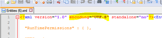

I'm trying to import an entity (Entities.xml) from one machine to another and getting below errors.
1. Internal error: com.sun.org.apache.xerces.internal.impl.io.MalformedByteSequenceException: Invalid byte 1 of 1-byte UTF-8 sequence.
2. [message: [1,013] Data store invalid session error: [Error occurred while accessing the model provider.]]
Note: both the machines has same configuration and TWX version.
What could be the reason of it?

Hi Tarun,  does the import works in different machine, i.e. the machine from where you have exported this current entity? If you have a tool something like Notepad++ you can open this entity.xml and check if it really is UTF-8, it shows up somewhere down right bottom in notepad++

Hi Sushant,
one is Dev machine and another is Test machine with same TWX instance. I took export from DEV and tried to import into Test but failed.
And yes exported file has encoding as UTF-8.
August 18, 2017
Could you please add  the screenshot of the status bar of Notepad++ where you have this file opened just just to confirm that Notepad++ also sees the encoding as UTF-8 (as mentioned in the screenshot i have shared above)
