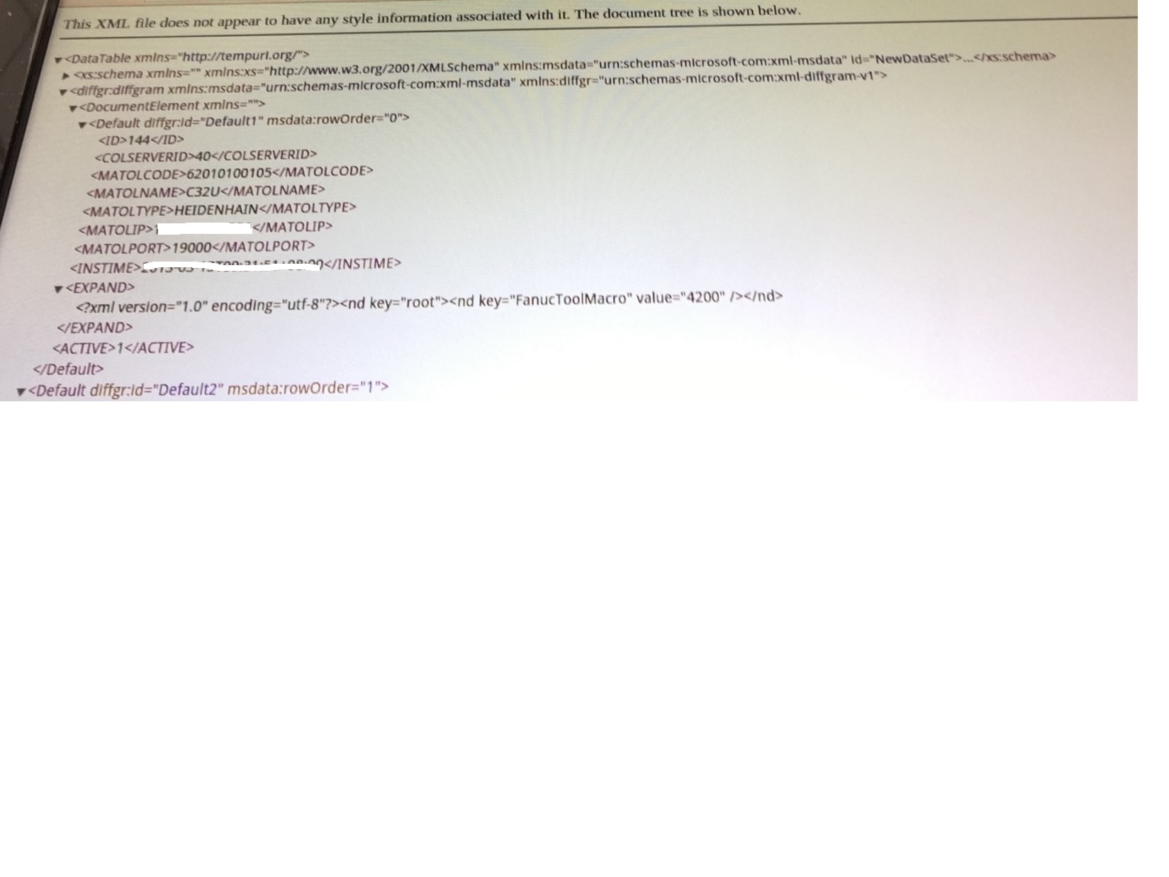

Help!Help!I need to parse this xml,anyone can help me?
Dear  all,
I need to parse the below XML ,Please  teach me how to parse it,thanks.
    PaiChungAnswer
    22-Sapphire I
    January 6, 2017
    generally you can use .*:: to escape name spaces
    so try MyXMLContent.*::.*::.ID
    or some length of that.

    Dear Michael Neumann,
    I need to change the XML to Infotable in Thingworx,but with the getXML() can't parse it.
    Do you have the experise to parse it ? If so ,please tell me how to parse it, thanks.
    December 29, 2016
    The getXML() will just return plain XML - so this needs to be recoded into an InfoTable.
    For this you will need to create a DataShape that holds the items you're interested in in the XML document.
    Let's take the Community Stats as examle...
    XML is here: https://community.thingworx.com/community/feeds/stats?community=2105
    I'm interested in the channel.item titles, links and descriptions.
    For this, create a DataShape "xmlParserTable" and in your service define the output Base Type as INFOTABLE with DataShape xmlParserTable.
    I'm using this as my code to a) read the xml b) define my InfoTable and c) put XML elements into the InfoTable to d) return the InfoTable

    I hope this helps...
    At least it should give you a start on how to read and interpret the XML structure putting it into the InfoTable
