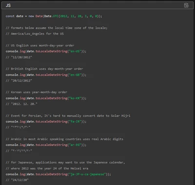

Hey all. I'm currently trying to work on localization so users from different countries will see dates in their proper format. I want to attach a location code to a profile and use that as a binding, so I tested with a very simple function to see if this approach would work. Below I've written some code that when I output to a div, outputs exactly as I expect in a quick demo React project when pushed to a div.
Code
Output
However, when I do this in Thingworx services, it fails to do this, and provides a completely different format. Does anyone know what is going on here? Am I making some sort of settings mistake?

Apologies for being a tad slow, as I'm technically off this week. I as specifically aiming to change the format based on the location. This will be accessible in multiple languages, and countries. So we want it to have one format for the US, another for the UK, another for Germany, and say if we were to introduce this to another language, we would like to be able to use the proper structure.
Specifically, we want the format to be changed just as it would be if we were using date.toLocaleDateString() as according to the mdn web docs located here.
To be clear, the screenshot already shows a string being printed out, not a DateTime, as with a DateTime object, the print out results in an error saying that strings cannot be converted to DateTimes.

I do not accept the response from @PaiChung as an answer. I have the same issue, please someone explain to me the result for the following code:
const event = new Date(Date.UTC(2012, 11, 20, 3, 0, 0));
const options = {
 weekday: 'long',
 year: 'numeric',
 month: 'long',
 day: 'numeric',
let result = [];
result.push(event.toLocaleDateString('de-DE', options));
// Expected output (varies according to local timezone): Donnerstag, 20. Dezember 2012
result.push(event.toLocaleDateString('ar-EG', options));
// Expected output (varies according to local timezone): الخميس، ٢٠ ديسمبر، ٢٠١٢
result.push(event.toLocaleDateString(undefined, options));
// Expected output (varies according to local timezone and default locale): Thursday, December 20, 2012
Output:
["December 20, 2012","December 20, 2012","December 20, 2012"]
The code is taken and slightly adjusted from official documentation.
Server running in UTC, Thingworx 9.3.9. .
Thank you
