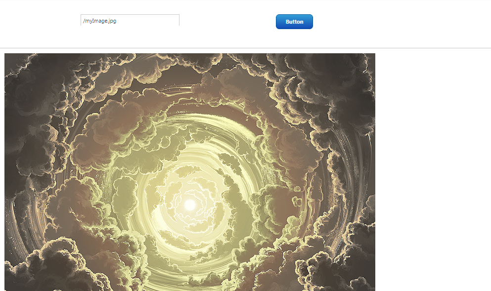

Here is what mine looks like:

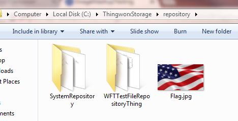

I have a image file Flag.jpg at location. C:\ThingworxStorage\repository (I assume its Thingworx repository)

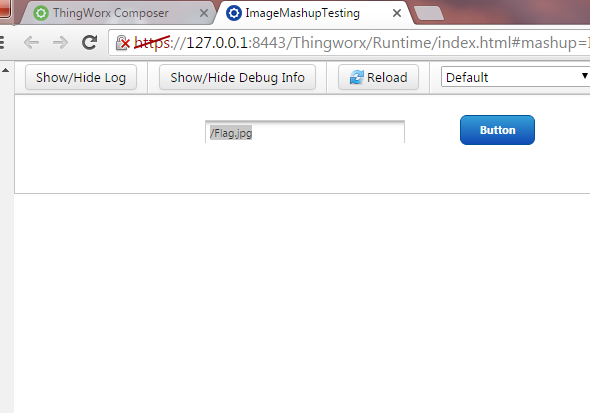

I followed the steps mentioned in above post & created Mashup. But when type /Flag.jpg in as image path and click button, image did not get displayed.

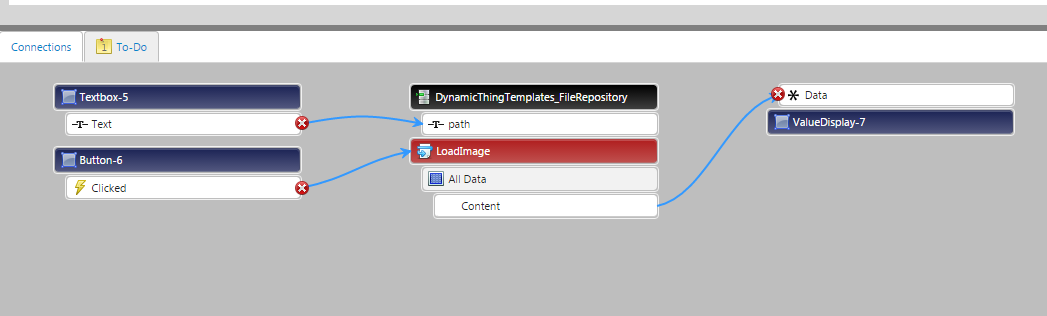

This my connections in composer.
Am I missing something?
October 12, 2016
Mithun, I believe it's not working in your case because you've chosen a dynamic service from the FileRepository Template itself (it doesn't know which repository to go to). You would need to either give it your repository name or select your repository directly (for example SystemRepository).
Try moving your image into SystemRepository (ThingworxStorage\repository\SystemRepository) and then use the LoadImage service on SystemRepository.
