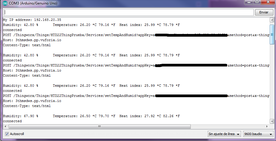

I'm using the Weather App with Arduino Uno​​ to connect a DHT22 sensor to the thingworx platform, but i have been unable to show the data from the sensor in thingworx. On the serial monitor I can see the values of temperature and humidity been updated, but not in thingworx (Thingworx 7).

I appreciate your help, thanks.

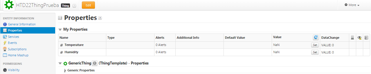

Hi Yajseel did you check the log for detail. I may be missing this here but looks like you are not using any of the ThingWorx Edge SDK is that correct? Else you should check the Edge SDK's log. Else please check for the Applicationlog.log from ThingWorx
How is the Thing's property i.e. Temperature and Humidity setup is it setup to fetch every change from the device?

What does the full POST URL look like? Taking a quick glance through the code, it looks like there are raw <> characters inserted in the URL just after printing out the `data` variable:
client.print("/Services/");
client.print(serviceName);
client.print(data);
client.print("<");
for (int idx = 0; idx < propertyCount; idx++)
  client.print("&");
  client.print(propertyNames[idx]);
  client.print("=");
  client.print(propertyValues[idx]);
client.print(">");
POST requests typically send the parameters in the request body with a content type of application/json specified. This link has more details:
