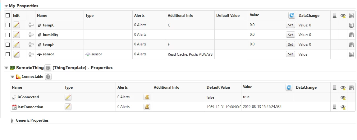

 I want to read the data from a vibration sensor connected to the raspberry through using the EMS and display that data on Thingworx .  My Python file is running fine. When I run ./wsems and ./luaScriptResource everything connects fine. The problem is the value column doesn't update in Thingworx.

ggmurp011-VisitorAuthor
Aug 13, 2019 9:07 PM UTC
I added %s to the string.format part and I'm still not seeing data push through to Thingworx:
local f = io.popen("python /home/pi/Desktop/vibe2.py")
local s = f:read("*a")
properties.sensor.value = s
f:close()
log.debug("[PiTemplate]", string.format("sensor %s", s))
end
My syntax seems to be correct but my data just doesn't seem to be where it needs to be.
