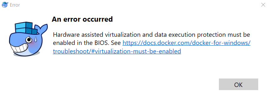

Hello. I tried to install TWX 8.0 docker (postgresql).
But, I got an error message below, beginning of progress bar.

    Hi Sangjoon Nam​,
    Did you check the log with:
    docker logs -f twxfoundation(twxfoundation is the ThingWorx instance name you gave when you install ThingWorx)?
    And, you could also check the installation log from: /tmp/bitrock_installer.log
    Br,
    Anna
    July 20, 2017
    Hi Sangjoon Nam
    It would also be interesting to know more details about your setup:
    - which OS are you using: Windows or Linux
    - which version of the OS
    - what is the version of docker (execute docker version command)
    - if you are using Windows, do you use Docker for Windows or Docker Toolbox
    Thank you
    Kind regards
    Christophe

    I have the same issue.
    I think that the problem should depend on this.

    Did you have a previous installation of ThingWorx Trial Edition on the same machine ?

    Solved for the same issue I found with ThingworxTrialEdition!
    - Download Docker for windws (toolbar for windows 7 or 8 as suggested in thingworx guide)
    - Download Thingworx
    - Check if virtualization is enabled (TaskManager--> Performance)
    Risultati immagini per task manager performance virtualization enabled
    - if disabled you must enable it from the bios (there's no other way) Enter in bios and in device option or system option you should have Virtualization enable flag (VTx only if you don't need IO or also VTd if you need I/O interaction.
    - Save and restart
    - Active Hyper-V (Enable-WindowsOptionalFeature -Online -FeatureName:Microsoft-Hyper-V -All by power shell or by programs features)
    - Install Docker and run it (now it should work - maybe it need reboot)
    - now you can run thingworx install as Admin
