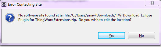

I get this error when I did that
February 26, 2016
Odd - looks like the Marketplace wrapped our plugin zip with another zip. You need to unzip the download first, to expose our plugin zip - then use the plugin zip to install into Eclipse.
Thanks for posting this - we will look into it.
