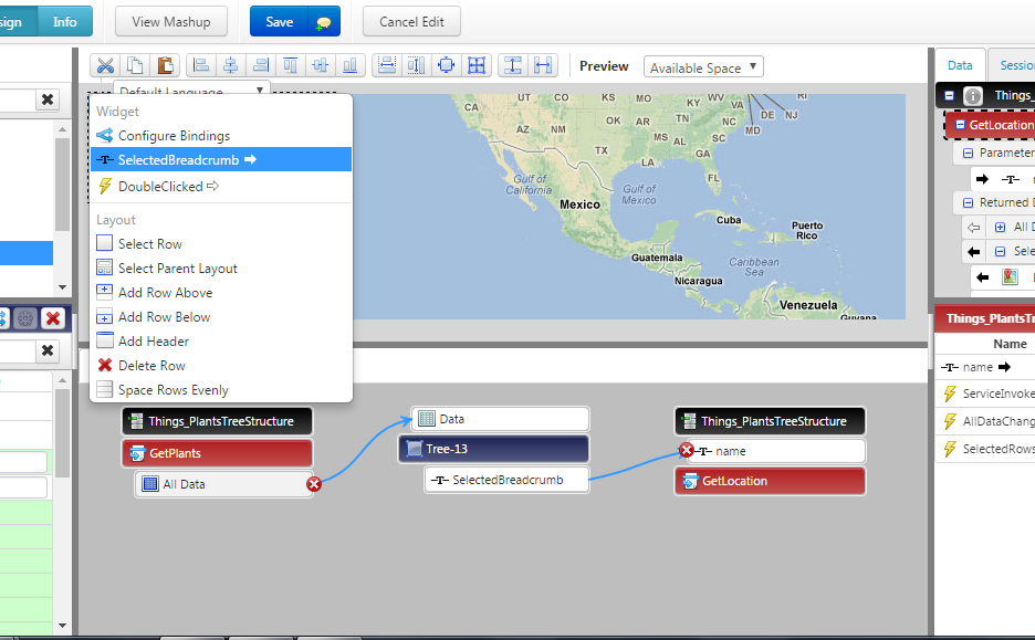

I have tree structure of continent, country and city, in a tree widget so what should my breadcrumb select give as a output? We need to pass the selected text as a service input.

    I think, I am not able to put myself correctly. My ultimate aim is to pass the selected parameter from tree widget to a service for data fetch. Using tree widget i have 3 options,
    1. configure bindings
    2. selected breadcrumb
    3. Double clicked
    Now i am sure configure binding will not allow me pass the selected node of tree, it can happen using selected breadcrumb or double clicked. Double clicked i checked can't be provided to a service as input. (For information my service is just a select query with [node name] in where clause).
    So only option for me is selected breadcrumb, which if connected to text box give o/p as "Parent node > Child node > Sub-child node". But I need only the sub-child node. For which I modified my query in the service suing indexing, but it seems to fail when i run the whole mashup. On the other hand if I run the service separately providing this input "Parent node > Child node > Sub-child node". It functions correctly.
    I hope I am clear. Please suggest what needs to be done.

    You must have used a service to add data to the Tree widget which would be in the form of an infotable. Basically, you want the parent entry of that Row as the selected text?
    If yes, my last comment would be helpful.
