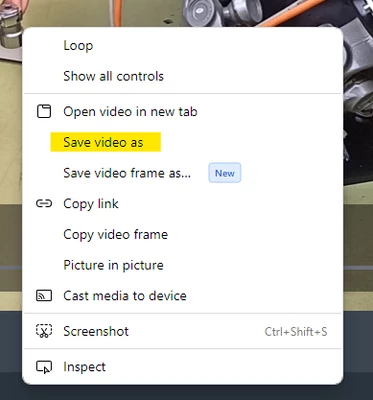

Presumably this is known. By clicking on a video with the right mouse button in the video editor of Vuforia Editor, each video can be saved to the local hard disk.
