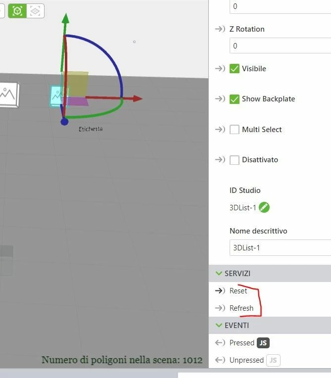

I tried the "Reset" and "Refresh" services but it doesn't seem to work

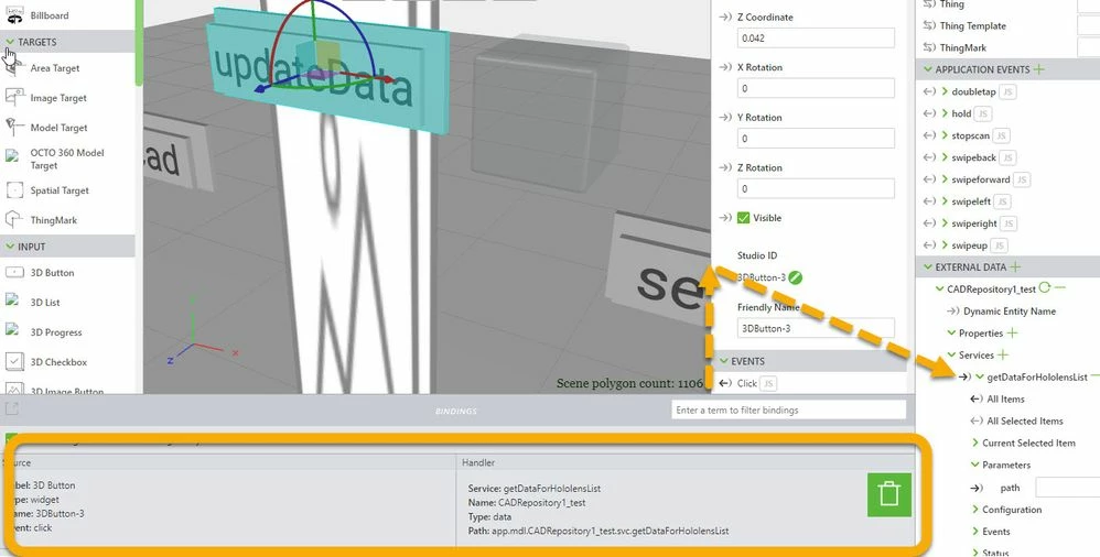

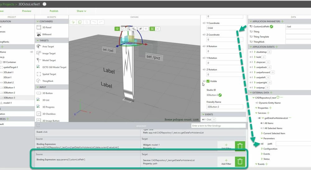

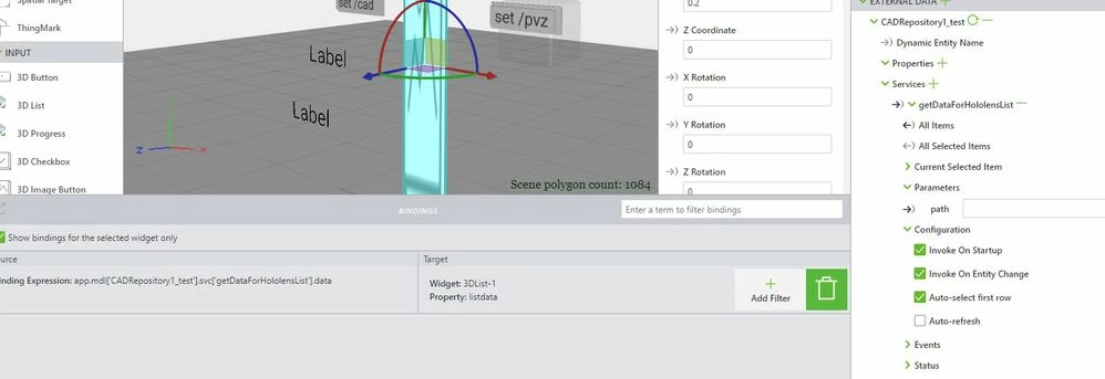

to point 2.)
the usage is according to picture:
path parameter is linked to app parameter CustomListPath - when we change it then we will change the path service parameter.
We need also to call the service  e.g. here getDataForHololensList. The one possible way is to click on button where the click event is linked do the service (explicit call)
or we can use the select event (implicit call) because the 3DList is linked to all Items - the results of the service getDataForHololensList(). and in the configuration of this service we will set that it should be called on  entity change- 2022-10-11_17-13-47.jpg
I think the mechanism is that both settings  will update the service with the current path when we click on Item in the 3dlist /item  selection in the 3D list.

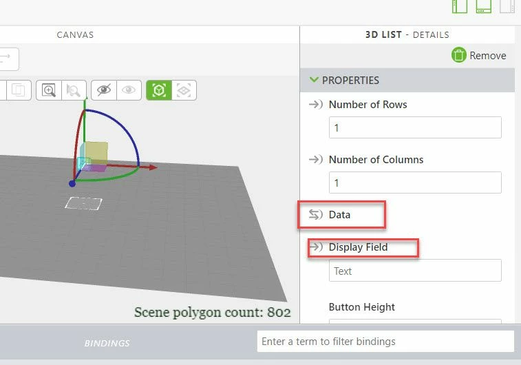

Hi @AndreaT ,
possibly you can clarify this points of your quesiton
We configured a Thing in hingworx to send to this widget the list of models that are saved in the server.
i can then load a specific model on fly.
For me is unfortunately not clear how was this (above) implemented. So the question is about the OCTO 3D List widget which has properties relevant for DATA : "Data" and "Display Field"
Are these properties pointing to models paths? Could you please, clarify or possibly provide more details about the values of these properties.

Hi @RolandRaytchev  and thanks for the suggestion.
The view change method, althought, doesn't seem to work.

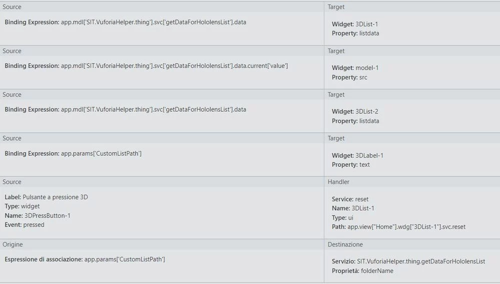

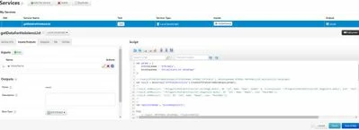

1- In the Data field, as you can see in the associations picture, I get the data from the twx service.
Basically a list of model paths is passed to the 3d-list and in the view I see as many buttons as list items (cad models saved in twx in that path),
Display field isn't used.
2- In thingworx we loaded some models into a specific path.
So what happens when I click on an element of the list is that it calls the model and loads that model and I can keep changing 3D models just by selecting each one from that list widget.
All the associations in the experience
This is the code in the Thing created in thingworx. Once the request is sent to the Service "SIT.VuforiaHelper.thing" I ask for the data

I also created an App parameter because at the time I didn't know how to change directly the variable "folderName" so I used this workaround to change the "customPath" value that then changes "folderName" value and also is displayed in a label.
Does this makes it a bit more clear?
Thank you very much
Sep 16, 2022 1:09 PM UTC
Hi @AndreaT ,
thanks for the feedback and the clarification. So far I understand here your usage is of service "getDataForHoloLensList" which returns a InfoTable with dataList containing some folders/paths of the Systemrepository- and this returned InfoTable which  should update the 3DList when you use different folder parameters . Right?
So the problem in your case is that with this service ( according to the  shown bindings in the provided picture)  will fill the  list only on  starttime of the  project when the project is loaded and the display will not  update any more the Octo 3Dlist widget when we call the service later? Right?
