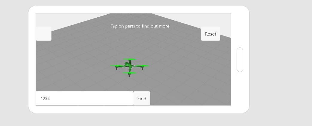

Hello Community,
By using PTC guide, I am creating Quadcopter project and I am replicating this. For this project, I am using PTC given code but not able to understand. In this, If I entered 1234 input in search bar and click on find button quadcopter model item lights are blowing. And If I entered 89 random input that time model item lights not blowing. But In this code, how they set this value not able to understand. If anyone is able to understand let me know. I attach preview page screenshot also. Please check this.

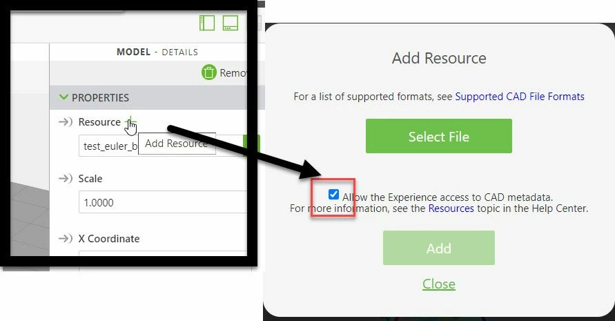

This is the metadata extraction via Studio UI standard functionality. So when you load a data
Because , possibly this project created long time ago so the metadata was not available - therefore we can not find there the json file corresponding to the pvz file->  extension .matadata.json. So I  moved the pvz file  ptc-quadcopter-animated.zip file from the project Upload folder. So simple I reloaded the resource using the flag Allo.... (picture above)

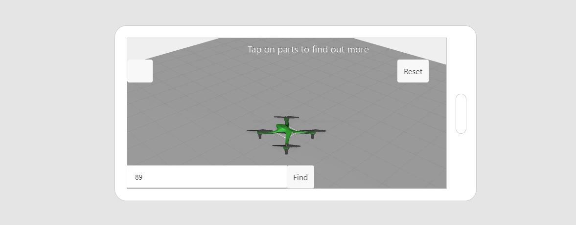

Hi @NP_10149671 ,
unfortunately is not clear what function you did call when you click the find button
So I believe you are calling the
$scope.findMeta()
which will take the text of your input from $scope.app.params.partno
The requirement that should work is that the input variable on the picture where your input e.g. 1234 has a binding to the value of the parameter partno
This should call the code
var options = metadata.find('partNumber').like(searchNum).getSelected();
where Studio will try to find and select all containing the value (as string ) of the partno parameter here '1234'
So this will look for the parameter (please check the ptc-quadcopter-animated.metadata.json -attached here /rename to txt) where we have an attribute 'partNumber' - but in this file  there is no such attribute so that this should not find anything . also input '89' should not find any thing because the attribute is wrong
I know that PartNumber is used sometimes especially form PLM but this should be an value in PVZ as valid attribute. Here you can use one of the attributes form the pvz file example for the Lithium-battery
,"/0/12":{"":{"Feature_Id":"310","Source_file_name":"lithium-battery.prt.1"},"PROE Parameters":{"DESCRIPTION":"","MODELED_BY":""},"__PV_SystemProperties":{"Child Count":"0","Component Name":"LITHIUM-BATTERY.PRT","Display Name":"LITHIUM-BATTERY.PRT","Model Extents (mm)":"65.6099","OL File Name":"l-Creo 3D_0_quadcopter-animal-asm_9.ol","Part Depth":"3","Part ID":"12","Part ID Path":"/0/12","Part Name":"LITHIUM-BATTERY.PRT","Part Path":"Illustration/QUADCOPTER-ANIMAL-ASM.ASM/LITHIUM-BATTERY.PRT"}},
you can use any others attribute from there e.g. Display Name :
var displayName = metadata.find('Display Name').like('BATTERY');
so means you can use 'Display Name' and input 'BATTERY' so that the selection will not be empty
"lights are blowing" - unfortunately I do not  have  idea what this mean but when I look in you code the options filed should be empty
options.forEach(function (i) {
identifiers.push('quadcopter-' + i)
}) //end forEach
// highlight each object in the identifiers array with the shader
$scope.hilite(identifiers, true)
So means that identifiers should be an empty array and have no effect so far I understand the code. B

Hello @RolandRaytchev ,
Thank you for your explanation.
Where you got this ptc-quadcopter-animated.metadata.json file? In every pvz file this attributes are already given?
