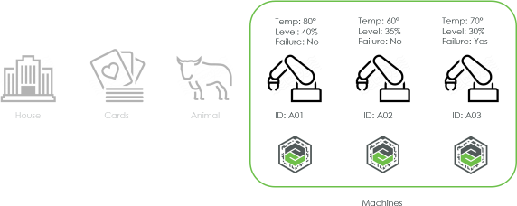

In an industry environment I could select the correct machine I'm looking at. However, what's the identifier? It is probably written somewhere on the back of the machine with lots of other information, so I don't really know what to look for.
Therefore I could be looking at any machine, but without the identifier I can not retrieve information for ​my​ machine.
Vuforia Studio uses ThingMarks​. They work similar to a QR-Code and allow for direct identification of individual machines. So instead of choosing manually in the app, the ThingMark automatically chooses the correct object and relates that ID to a Thing Entity in ThingWorx.
In above image, the ThingMark allows to a) identify we're looking at a machine and b) are looking at the specific machine A03
It's basic point and shoot. Scan the ThingMark with your mobile device and you're directly taken to this particular experience for this particular machine.
In this case, it's not the machine that defines our object's properties and shapes and contrasts and sizes etc.
In this case, it's the ThingMark that's the object being recognized.
That's quite a difference.
So now, in an additional step, we're using the power of Vuforia to identify individual machines by a ThingMark.
Recognition is driven by the ThingMark's shape which includes an encoded object ID (the QR-code looking pattern).
How does ThingWorx fit in?
After recognizing the machine, ThingWorx studio provides the link between this specific object (or its instance) and the ThingWorx Thing Entity we've defined in Vuforia Studio.
This allows to retrieve individual properties, services, events, alerts etc. directly via ThingWorx.
Those values are unique per object, not per shape!
So this allows to directly look at temperature, level and failure-indicator for the actual machine in front of us:

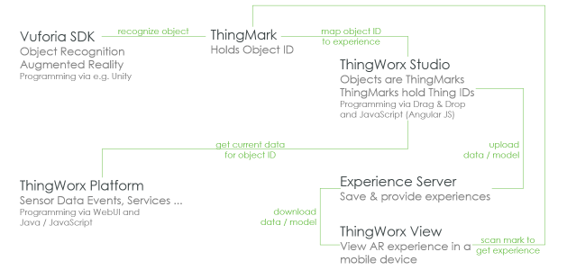

There are quite some components involved in this:
This can be split into two processes: developing and experiencing
Development
  1. Create a new experience in VuforiaStudio, map the experience to the ThingMark ID, map the experience to a Thing Entity in ThingWorx.
  2. Publish the experience to the Experience Server.
  3. Done.
Experience
  1. Scan the ThingMark with the Vuforia View app.
  2. Vuforia View will utilize Vuforia to recognize the ThingMark
  3. Vuforia View will load the data and the model(s) for this ThingMark from the Experience Server
  4. Vuforia View will automatically receive and update the experience you're viewing with live data from the ThingWorx platform
  5. Enjoy.
