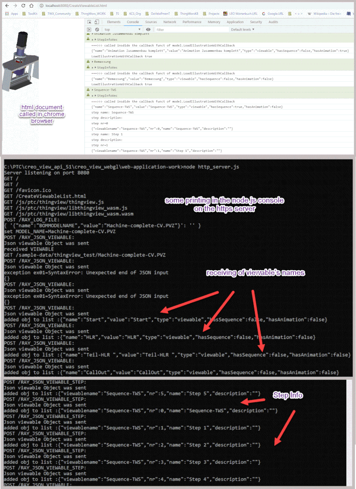

When the Creo View WegGl program is started (load  the html file from the http server)  - on the server side - in the node.js console  we can see the printing of the received data - example on the picture below:
The Creo View WebGl program will create on the server side  2 json files (this requires also handling of the received  data on the server side as allready mention in the post [1.]  )
For the data extraction I used in this example the PTC demo file (provided with the installation of Creo View Toolkit) : worldcar-brake-multi-figure.pvz,
worldcar-brake-multi-figure.pvz-viewableSteplist.json
[{"viewablename":"Sequence","nr":0,"name":"Sequence","description":""},
{"viewablename":"Sequence","nr":1,"name":"Step 1","description":"Remove spring clips"},
{"viewablename":"Sequence","nr":2,"name":"Step 2","description":"Release 4 bolts"},
{"viewablename":"Sequence","nr":3,"name":"Step 3","description":"Pull apart the calipers"}]
worldcar-brake-multi-figure.pvz-viewablelist.json
[{"name":"Figure 1","value":"Figure 1","type":"viewable","hasSequence":false,"hasAnimation":false},
{"name":"Sequence","value":"Sequence","type":"viewable","hasSequence":true,"hasAnimation":false},
{"name":"Parts List","value":"Parts List","type":"viewable","hasSequence":false,"hasAnimation":false},
{"name":"Sectioning","value":"Sectioning","type":"viewable","hasSequence":false,"hasAnimation":false},
{"name":"Translation","value":"Translation","type":"viewable","hasSequence":false,"hasAnimation":false},
{"name":"Animation","value":"Animation","type":"viewable","hasSequence":false,"hasAnimation":true}]

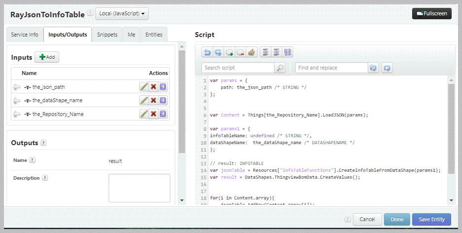

Here the first Step is to define a general service which will will convert the JSON file from a file repository to an InfoTable using particular dataShape.  The json file will be taken from a  repository:
var params = {
	path: the_json_path /* STRING */
var Content = Things[the_Repository_Name].LoadJSON(params);
var params1 = {
infoTableName: undefined /* STRING */,
dataShapeName: the_dataShape_name /* DATASHAPENAME */
// result: INFOTABLE
var jsonTable = Resources["InfoTableFunctions"].CreateInfoTableFromDataShape(params1);
var result = DataShapes.ThingviewBomData.CreateValues();
for(i in Content.array){
 jsonTable.AddRow(Content.array[i]);
result = jsonTable; //returns the InfoTable
The service has 3 Input parameters : the_json_path, the_dataShape_name and the_Repository_Name (all are String type)

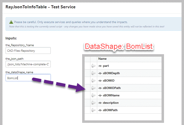

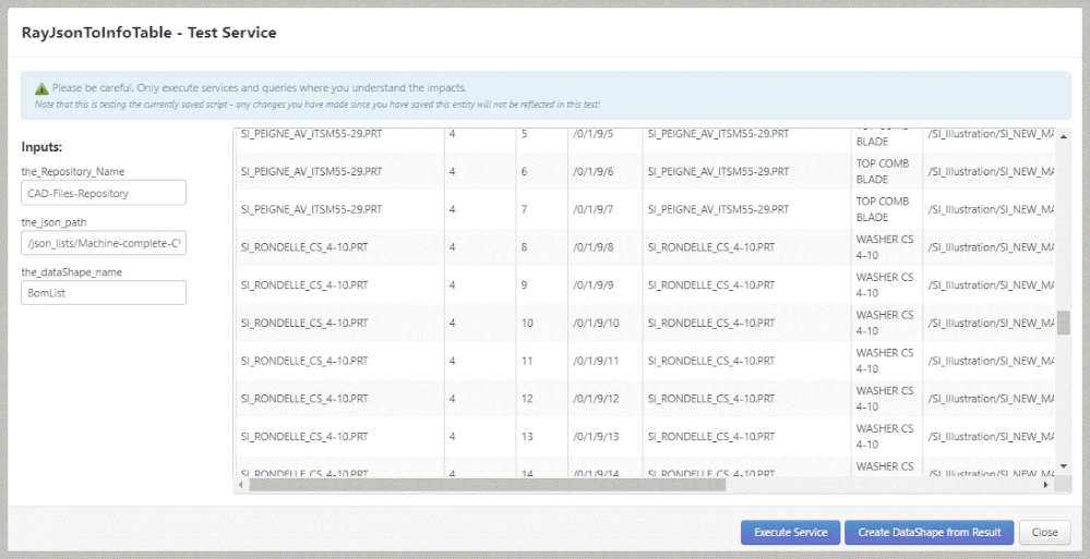

This service could be called for any filerepository, containing any json files(it is not file specific) . Via the dataShape name we will specify the filed definitions.  We need to do this  for each specific json file. In this case we have to  create first manually a DataShape which is compatible to the Json Object.  For example when we start the service RayJsonToInfoTable:
And the dataShape what we need to define for  this particular example:

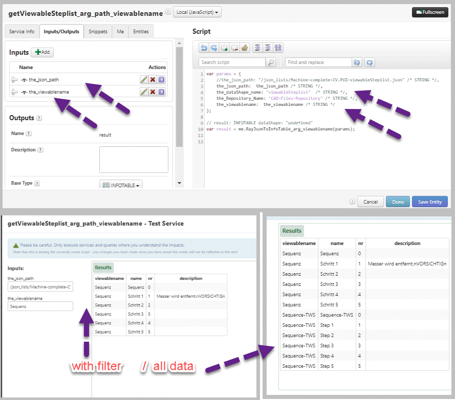

For the achieving  of the final goal -> the creation of the  Sequence Step List. We need to create a  another service where we can specify the arguments for DataShape and  repository name. Example:
So the input argumets are:
I.) the path to the json file
and
II.) the name of the sequence for which we want to see the steps.
