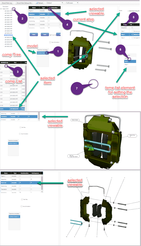

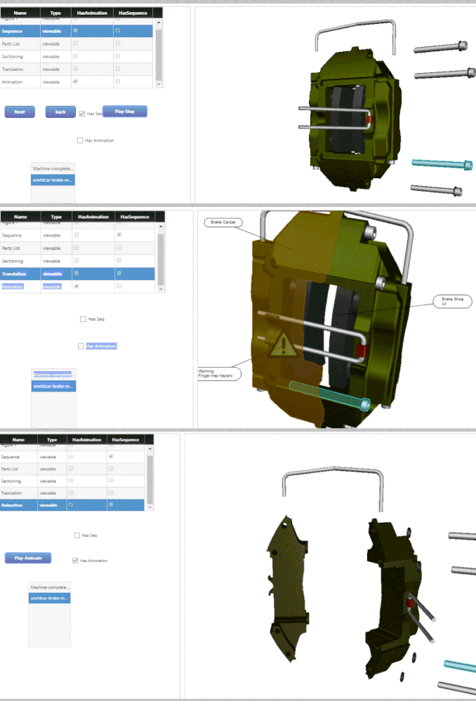

In the picture above, we have an example for customized mashup where we have a different areas for the different functionality. The mashup displayed in design /edit mode should looks like:

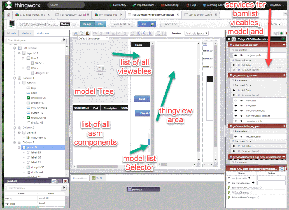

The mashup contains the following main areas(marked in the picture with a callouts numbers 😞

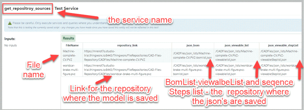

1.) Selector for the models. This is a list element widget which provides the possibility for the  selection of a particular model. The list  here is based on an Infotable returned by a service. Here is an example how to implement such service:
For simplification reason the service contains here only 2 rows.

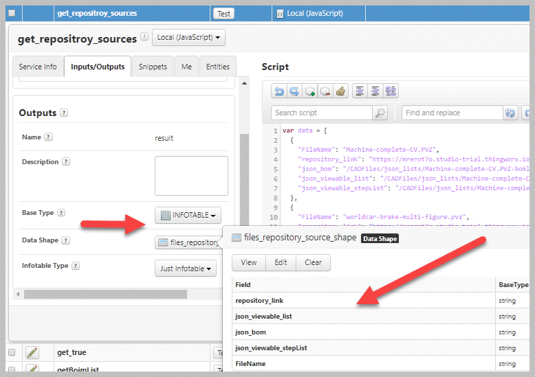

Here is an example how to implement such service (javaScript code) :

var result = DataShapes.files_repository_source_shape.CreateValues();
for(var i =0;i<data.length;i++) {
 result.AddRow(data[i]);
The return type of the service is an InfoTable . For the defintion of the InfoTable we need a DataShape for the used fields definitions:

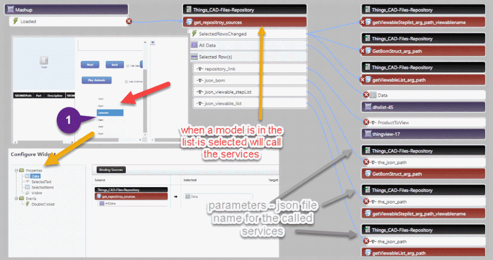

The list Widget ( callout 1.)  in the picture) has a binding to the thingview data.  When we select in the list widget a model -> this will call  the services:
{(getViewableSteplist_arg_path(), getViewableSteplist_arg_path_viewablename()  and GetBomStruct_arg_path() }  of the  CAD-Files-Repository (Repository Thing - means  a thing which uses the template FileRepository)  -> and will pass the arguments for the json files paths for bom , viewables and StepList .
The effect is that- when we select a model in the listWidget -> this will update the mashup and will display only data related to this model.  All models and Json Files in this example  are saved in the Repository "CAD-Files-Repository"

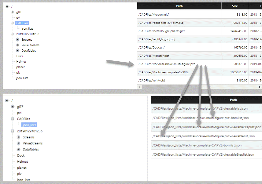

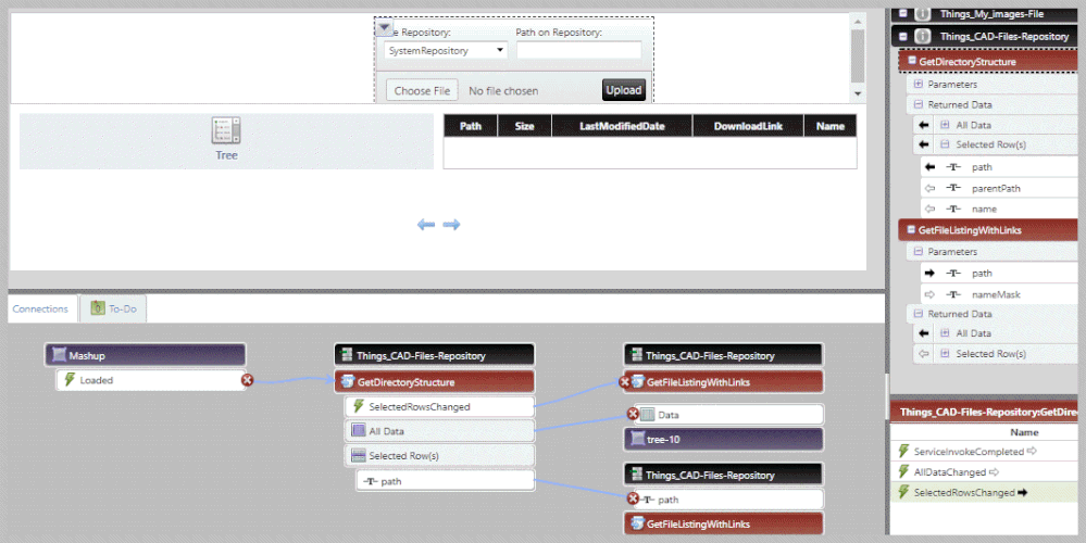

  • To upload data to the repository we can use the File Upload widget.
  • To display (for testing)  the data we can use the GetDirectory() and GetFileListingWithLinks() services of the repositroy thing.
Below is an example for tool mashup which could be used as a tool to upload and display the data in the repository -as shown in the  picture above:

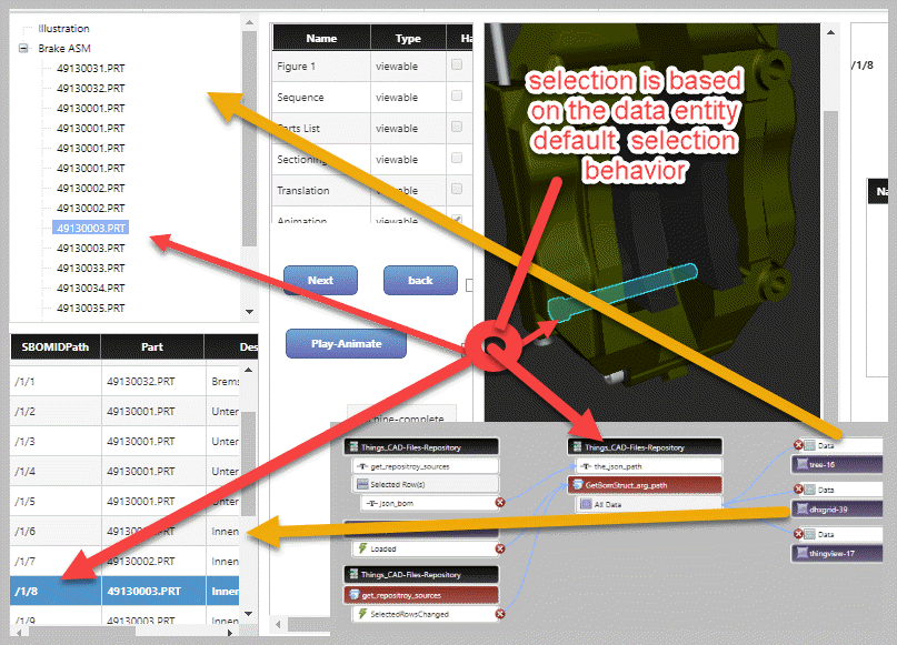

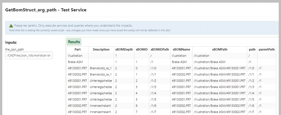

2.) Model tree area (callout 2.). This will display the model tree of the assembly components. It requires a service returning an InfoTable.  - here an example the service {Things["CAD-Files-Repository"]. GetBomStruct_arg_path(the_json_path) }  is called and returns the folloiwng   output:
For the creation of the infoTable I used  here a json file. In this example the the information about the viewalbes and steps  was extracted from  PTC sample assemble worldcar-brake-multi-figure.pvz   to the file  "worldcar-brake-multi-figure.pvz-viewableSteplist.json" (attached to this post). How to generate such file with Creo View WebGL toolkit is described in the community post (How to extract the components with properties from a pvz file)
The step how to create an InfoTable  from a  Json will is handled in an addtional post (Service for creating of Bom - and Viewable Lists from json files)

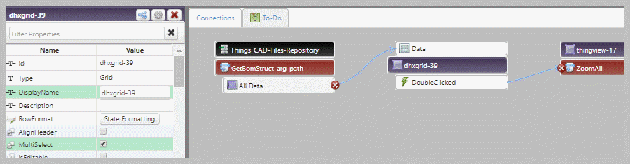

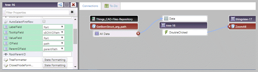

For the  displays of the data as an assembly  tree the tree widget has the following settings:
3.) List area - the functionality in this area uses  the same services as in point 2.)  but it  displays the components bom in a Thingworx Grid widget.  This will list the Bom as list of all components  (uses also the service {Things["CAD-Files-Repository"]. GetBomStruct_arg_path(the_json_path) } )
In the mashup preview it will looks like:
4.) Area for the selection of a viewable /  viewable = Creo Illustrate Figures ( callout 3  in the  the overview picture)

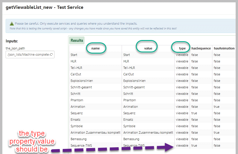

To  display the viewables correctly in thingview we require to have a service/data which is based on InfoTable with specific field definition (specific field name + type  is important that it works)

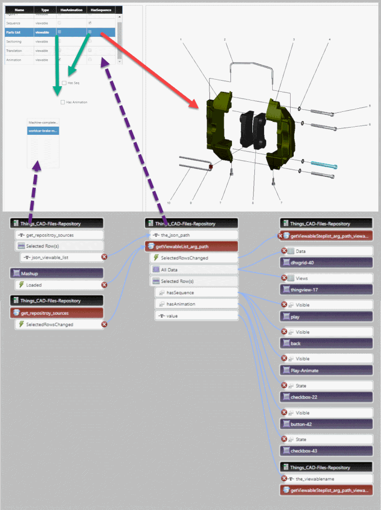

We can bind the All Data of the service  (here : {Things["CAD-Files-Repository"]. getViewableList_arg_path(the_json_path) } ) to the Views property of the thingview widget. Depending on the values of the fileds HasAnimation and HasSequnece the buttons for playing of sequences and animation are shown or blanked (set the Visible property to true or false)
How to define the service used for this point (returns InfoTable with list of the viewables) is described in the post  (Service for creating of Bom - and Viewable Lists from json files)

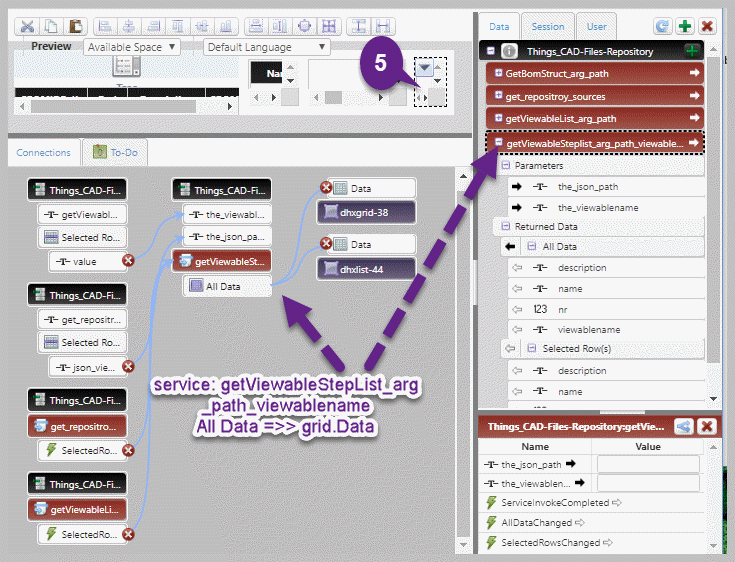

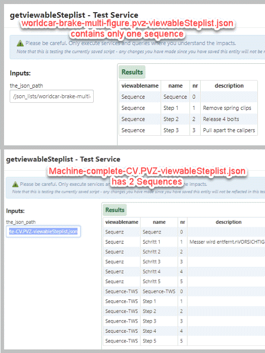

5.) Area for the display of the  sequence steps > data grid widget-> it displays data  only if the current viewable is a sequence.  Here  below an example for the results of the service execution (getviewableStepList )   for a Json files related to  models which have 1 (worldcar-brake-multi-figure.pvz)  respectively  2 (Machine-complete-CV.pvz) sequences.
In the attached sample file  you can find  the  json file:  (worldcar-brake-multi-figure.pvz-viewableSteplist.json)

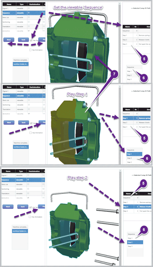

Here is an example of the mashup dipslay where we can see a Sequnece containing viewables
We can see the same mashup in design/edit mode (below). We can bind the All Data of the service  (here : {Things["CAD-Files-Repository"]. getViewableSteplist__arg_path_viewablename(the_json_path, the_viewablename) } ) to the Data property of the grid  widget.
How to extract  a json file from the pvz model (e.g. worldcar-brake-multi-figure.pvz-viewableSteplist.json) and how to define the service for lnfoTable generation  e.g. getViewableSteplist_arg_path_viewablename -> this is shown in the post (Extracting the viewables and the seqnece steps information from a .pvz file for the usage in TWX).
 The display of the Step List  is here provided only as info. Because there  was not possible to set the current /selected dataset in the grid widget. Therefore I used  here an additional List widget (callOut 6 ) which helps to manage this problem
6.) The area of the List widget is an area  which should be made invisible. It is used only to allow the setting of the selection in the grid element. We can bind the All Data of the service  (here : {Things["CAD-Files-Repository"].getViewableSteplist__arg_path_viewablename(the_json_path, the_viewablename) } ) to the Data property of the List  widget (callOut 6). The list element ( 6.) could be blanked because it is only used to set the selection of the  gird table (default  functionality of the Data selection )
How to extract  a json file from the pvz model (e.g. worldcar-brake-multi-figure.pvz-viewableSteplist.json) and to define the service for it  e.g. getViewableSteplist_arg_path_viewablename - is shown in the post(Extracting the viewables and the seqnece steps information from a .pvz file for the usage in TWX).

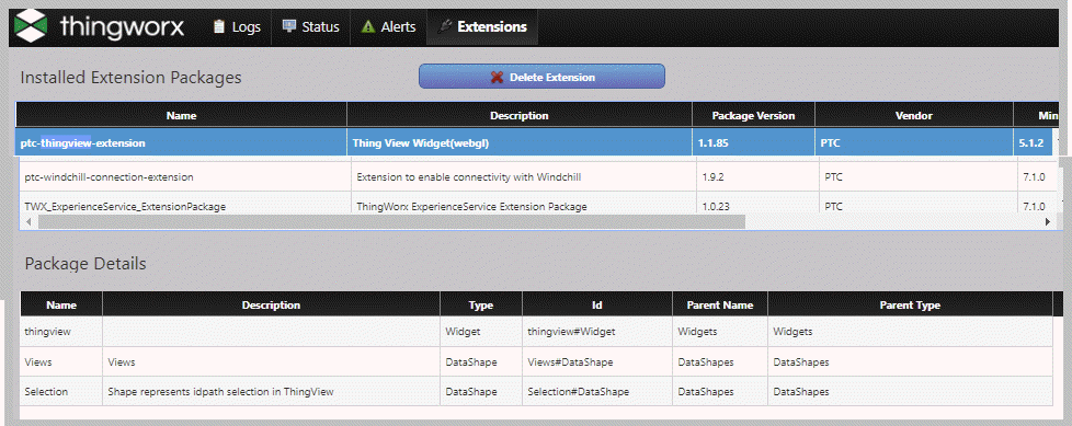

7.) This is the area with the panel of the Thingview (Thingview is a thingworx  extension). The thingview widget is part of the windchill navigate module. If the extension is installed , we can check this in the Extension manager:
In the package details we can see  that the thingview widget is installed on this thingworx instance
