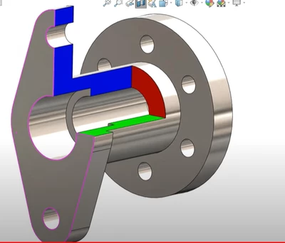

Often, we need to display some sections, or we required to have a view of a x-section of the model.
This is in generally no part of the current functionality but there are some approaches which could be helpful.
In this article I want to mention 3 different approaches, which could be used but no one of them is really perfect:

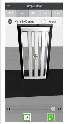

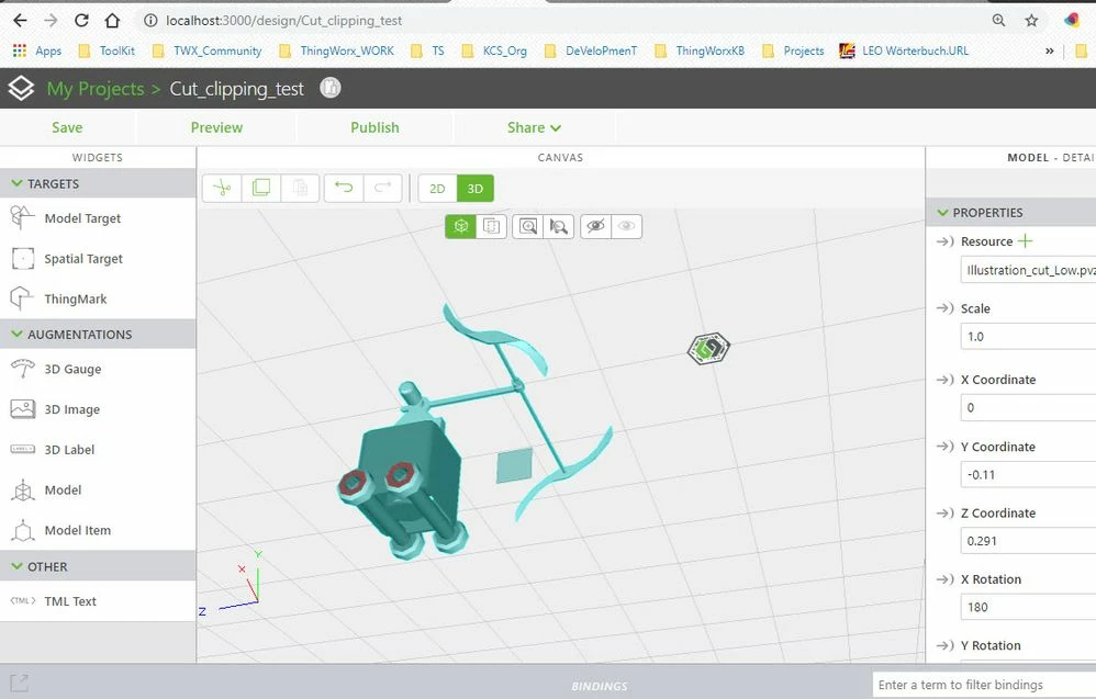

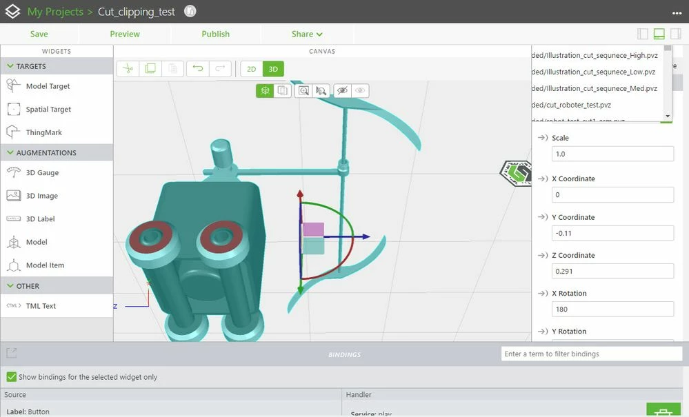

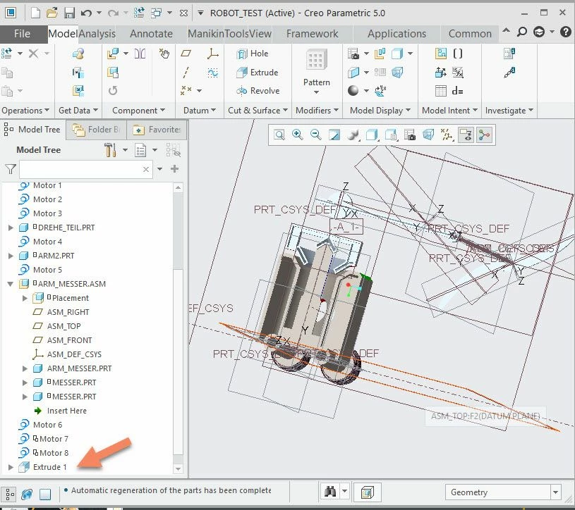

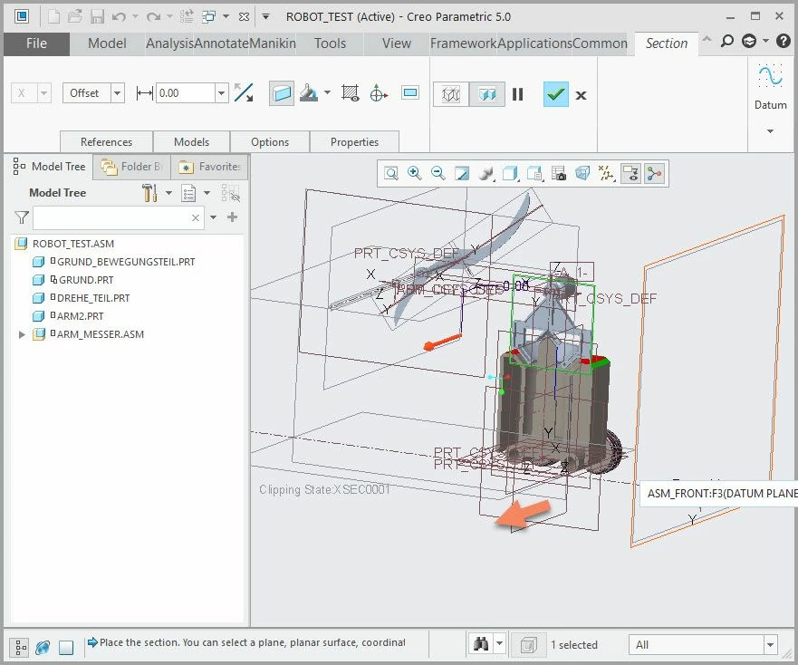

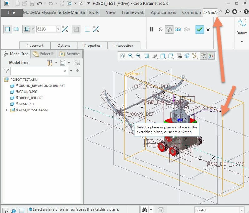

1.) uploading different models -  so we can use an additional models for each cut and then we can change the model if you want to display a cut, it means you can make the one model not visible and the display the second model or vice versa.  I tested with cuts created in Creo Illustrate 5.0 and Creo View 5.0 but it seems that Vuforia Studio could not display them /neither as part of sequence or as static to the current figure:
The only possible  way in this example is to create in Creo an assembly cut /with option cut also on part level  and  then create from there a new .pvz model.
In this case this seems to work fine:

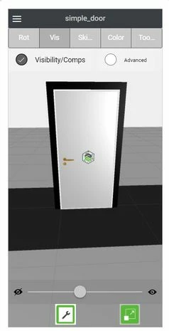

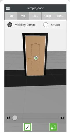

2.) the second approach is to remove components  step  by step,  so to see the inner components when the outer components are blanked:
All different components, which should be displayed or blanked, need to be defined as modelItem where we can set the visible property to true or false
Is also possible to blank or display  a list of components where the list is defined in json file. This could be done with JavaScript code. In this case we do not need to define a modelItem widgets.  For more information you can check the post

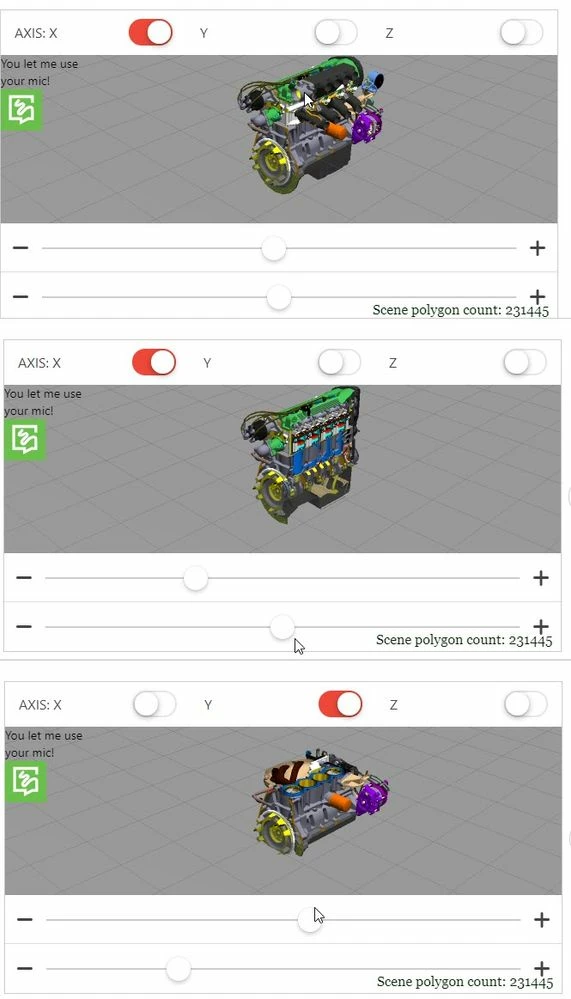

The last most powerful option is to use a shader for the model Widget. So for example we can use some kind of clipping functionality of the model where we can set the x min and x max value or ymin and ymax or zmin and zmax value what should be displayed. This will create a clipping effect. So only the geometry which satisfy this criteria will be displayed.
How to achieve a clipping functionality using a shader.
3.1) define a shader - this requires creating a tmlText widget where we can define the shader Code. The code should be inserted into the text property of the tml widget
For the clipping along x axis with planes which are parallel to the  YZ plain we need to define the following javascript with GLSL:

To set the clipping values for different axes and to control it by   sliders we can use some code like this:
$scope.DIR="y";
$scope.slice = function() {
 var slicexCur = ($scope.view.wdg['slider-1']['value']/100.0)-0.5;
 var slicewidthCur = ($scope.view.wdg['slider-2']['value']/100.0);
 $scope.view.wdg['modelx']['shader'] = "slice_world_based_"+$scope.DIR+";slicex f "+ slicexCur + ";slicewidth f " + slicewidthCur;

Here the slice() function is called in the slider change event (for the both slider widgets).
For better understanding of the functionality you can review the attached Vuforia Studio project

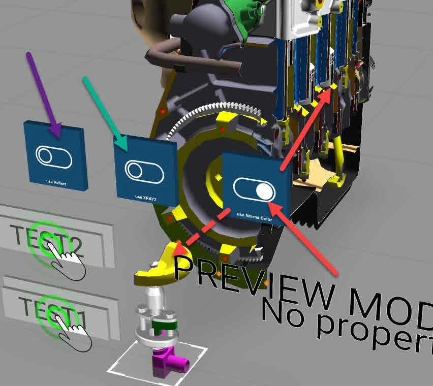

To cover this functionality the dev team developed some studio extensions that  PTC customers can use instead.   That extensions widgets will handle reflections etc, and I it is recommend to use  those extensions .:
  1. https://github.com/steveghee/OCTO_Studio_extensions
  2. https://github.com/steveghee/OCTO_effects_extensions
