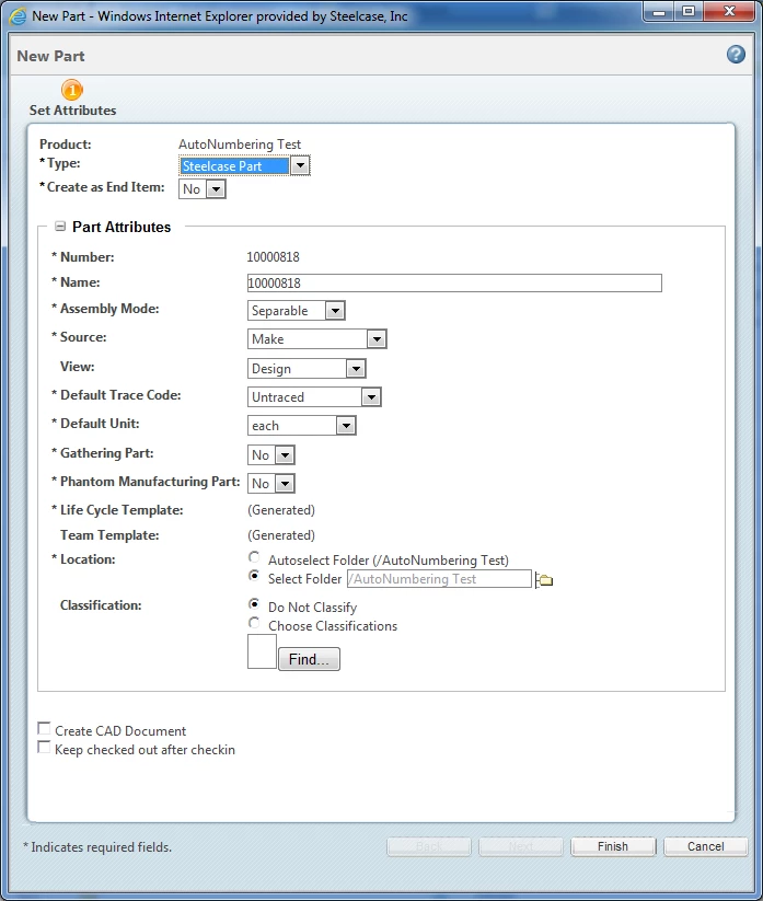

So I added my attribute (Part Name) to the Part Master and when I create a WTPart I don't see the attribute. Is there more configuration that I'm missing?

The attribute was already added by default to the layouts. I have found SPR 2122195 which was reported back in March of this year and no expected fix release. I'm curious as to why PTC allows the addition of user defined master attributes but doesn't show it in any other area of the software???
SPR
2122195
Status
Open
Severity
High
Created Date
23-Mar-2012
Description
How to edit WTPart Master attributes in the User Interface?
Edit Common Attributes dont show it.
