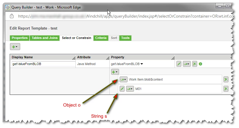

Can anyone suggest how to improve the performance of this Java Method?
I'm using it in query builder to get the value of workflow variables from WorkItem.blob$context.
Originally I used two separate methods which were nested to first deserialize then extract the variable with another custom method.
After I combined the two methods into one as suggested here the report is faster, but I feel it could still be improved further.

 //pass in a BLOB (Object o) and Workflow Variable name (String s)
 //returns the value of the workflow variable (int)
 public static int getValueFromBLOB(final Object o, final String s) throws WTException {

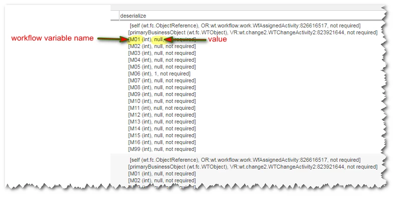

		//find the comma after the variable name and the next comma after
		//the split the string
		//convert the string to an int
		int val;
		int indexOfs = object.toString().indexOf(s);
		int indexOfcomma = object.toString().indexOf(",", indexOfs);
		int indexOfEndcomma = object.toString().indexOf(",", (indexOfcomma + 1));
		String checkNull = object.toString().substring((indexOfcomma + 2),(indexOfcomma + 6));

Example of the deserialzed BLOB before extracting the variable:
The code searches the de-serialised blob for a string like the variable name, then the next commas, then gets the substring using the position of the comma either side either side of the value.
Basically I think what I'm asking is how do I address these [(),,]
