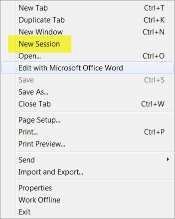

At one point in time I was able to log into Windchill as an admin and also login as a user. Due to some update, I am no longer able to do so. Can anyone point me to the browser setting that will allow this behavior? As I am building a WC 9.1 upgrade environment, it would be so helpful to have both logins.

Kathy, I use multiple logins all the time using IE8.
after logging in as the first user, select "New Session" from the
"File" menu. This will open a new session of ie8 and will allow you to
login as the second user.
John

Or you can just add -noframemerging in the target line for a separate shortcut to IE on your desktop.
This is from a 64-bit XP and works fine for me: "C:\Program Files (x86)\Internet Explorer\iexplore.exe" -noframemerging
Every window spawned from that shortcut will give you a separate session.
//Richard
April 14, 2011
Richard,
You are the man!! Adding this argument to the IE desktop shortcut works great !
I use this method of opening multiple browsers (as different users) for testing workflows all the time, and this was a real problem. Thanks for sharing this solution.
