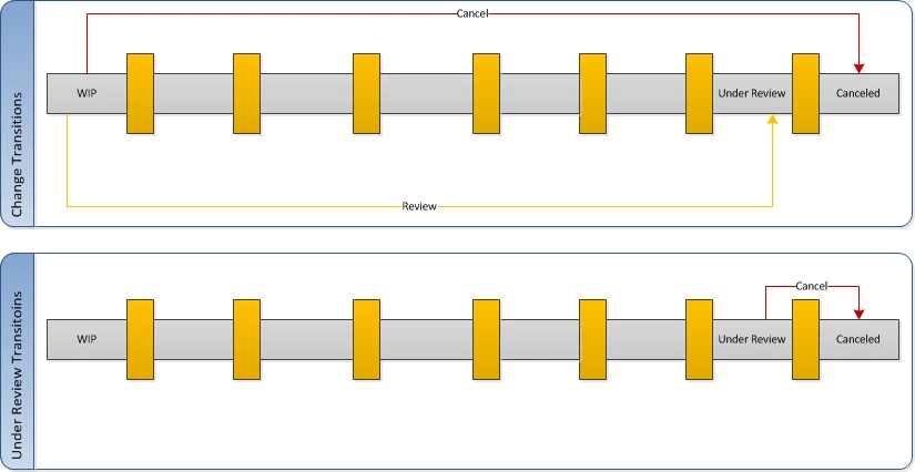

When I setup Change Management, I typically use a change transition to move Resulting Objects on the change task to "Under Review" once the task goes out for Review at the very least once the task is Resolved. This mimics the Promotion Request's "Lock" and protects the data while its out for review and also while the other tasks are being completed (takes a while at times).

You could also define the cancel transition for the under review state that mimics the rework transition target state. Then build the proper wf steps to execute the cancel transition.

Wouldn’t this just put both objects back at whatever state I click for the “cancel” transition though?

Well that depends on how you implement the cancel transition. You could make the case that Cancel means to put the objects back into an in work state much like you would define for the Refine transition. Or you could say that that Cancel means to put the objects themselves to a Canceled state to record that their Change was not approved but actually canceled.
In short, Yes, the cancel transition would put both objects to the state defined by cancel… After closer analysis of your original question I think I may have spotted your “real” problem. I also faced this problem when analyzing our own change process. Your problem is that you don’t ever know what the state of the objects is before they are move to Under Review by the Review transition. What makes your problem even harder is that you have more than one state under which a user can modify an object. If you have only a single modification state then this greatly simplifies your definitions of the transitions. Basically every transition you define for your “from” states, must also be defined for the Under Review state. See the example below:
