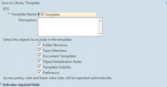

I am implementing Windchill in a customer which wants to have the same folder structure replicated in every first level folder, what's the easyest way to achieve this.
Once they have "|" in the name of numerous folders I can't create the folder structure in windows and then import to Windchill...

Guilherme,
if you use templates you are able to create a new product or library with the same structure, as you can see on attached image.
Marco

July 10, 2014
  • If you are working in product and libraries, you can use a template to recreate the folder structure. See CS129445
  • If you are working in projects or programs (ProjectLink), you can use the Export to File action and only select "Folder Structure" in the export options. See "Exporting a Project or Program"
  • If you want to recreate folder structures within the same context, or within existing products and libraries, then there is a workaround that is slightly tedious depending on how many folders you're working with.
    1. Ensure each folder one document within it that has been created from a local file. If they don't, upload a placeholder document with a unique name. For example, "StructureABC.txt" and then copy and paste it into each folder and subfolder.
      This is the tedious part, but theoretically you'd only need to do it once. If you are using desktop integration, you can do this really quickly from Windows Explorer. (For all folders except for the ones that include a restricted character in the folder name.)
    2. Select the top folder and the perform a Download Documents to Compressed File operation. Make sure you select the following options: Include contents of subfolders and Save full path information
    3. This creates "document_contents.zip" to save locally. If you open in, the folders with restricted characters ("|") are hidden, but that's ok.
    4. Navigate to where you want to duplicate the folder structure and perform the Upload Documents from a Compressed File operation. Make sure you select the Use folder names checkbox.
    5. This will recreate the structure of all folders that had a document saved within it.
    6. Perform a global search for the placeholder document ("StructureABC.txt" in this example) and then use the Search Results table to delete all instances of that document at once.
