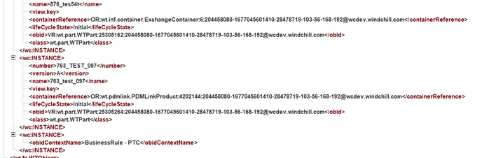

Custom Webject not working as expected
I am using Windchill PDMLink Release 12.1 and Datecode with CPS 12.1.2.0
I have created two webjects one is Search-Objects and another is custom webject. I'm passing the object id to the custom webject as input and I am getting the actual value as a output. But the issue is, in the output result only for the last object the custom value is showing not for others.

    This would work but another option for less effort could be to extend the already existing ObjectWebject class that already has that function. In the example below you can use getUfidsAsGroup then loop through the group and perform actions on each element, like get the context just for an example, then add to the group_out.

    @RG_10893406.. can you upload the two webjects you are using?
    7-Bedrock
    Jul 29, 2024 4:18 AM UTC
    From Search-Objects webject im getting the parts details, and Context-Name Webject is the custom webject which we have created. Using Return-Group webject im combining both webject data. But the data is not combining. The custom data is showing for only the last object.
