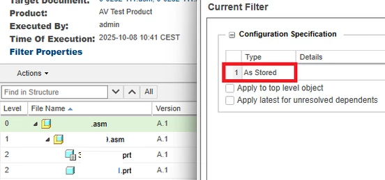

Hi @EMore
The Query Builder can not call recursively an another report so you can not get the multilevel bom just by the Query Builder.
Why do you not use the Structure BOM Report? it can generate the multilevel BOM with attributes you need.
Otherwise you have to write own function to generate BOM as you need with recursive function.
PS> as stored configuration for WTPart does not exist. So you have to play with the modification time and it is really too complicated.
