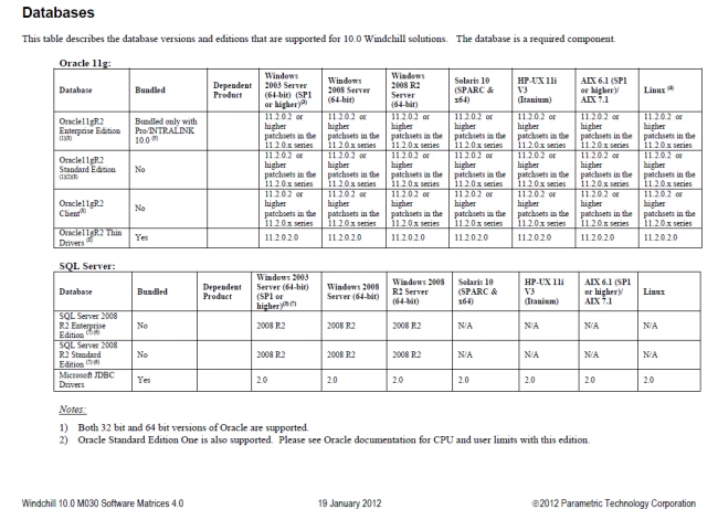

After I sent him the PDF linked below, my IT guy asked me to ask you people
"Can we use SQL Server instead of oracle?".
Joe S.
January 30, 2012
Let me clarify this question. Which is better? Oracle or SQL Server for
a database?
How do I know if we are licensed for Oracle (seeing how we've been using it
for 13 years or more)?
Personally Oracle gives me the warmfuzzies because of how Intralink3.X has
always been FAST! As a user, performace is always the #1 concern.
Thanks again,
Joe S.
January 30, 2012
I have heard that 80% of new installs are going on SQLServer and it is faster than Oracle.
Whoever, if you are planning a multiple site, multiple country implementation then use Oracle.
If you must use a Un*x OS, you can only use Oracle.
PTC seems to be pushing the use of Windchill down to the standalone shops with 2-5 seats of Pro/Engineer. In these cases SQLServer is ideal.
This makes the 80% of new installs using SQLServer a valid statement, but is it reality?
Thank you,
Ben H. Loosli
USEC, INC.
January 30, 2012
Hi Joe
This is taken from the Windchill 10.0 Software Matrices document
January 30, 2012
