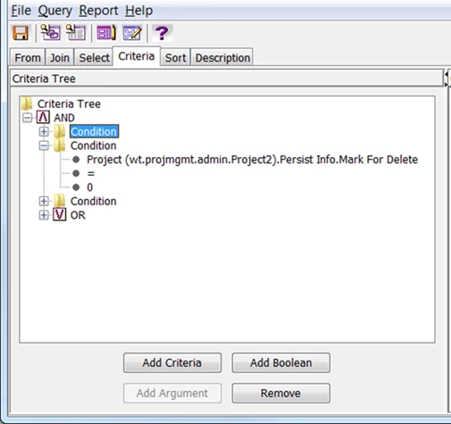

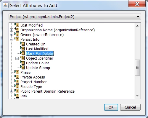

Hi Richard,
You can filter these projects out in the criteria using the "Marked
for Delete" attribute as shown below. Values are 1 for true and 0 for
false.
Hope this helps,
Dax Williams
