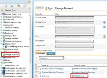

I have soft typed the CN to an ECN. In the workflow I removed the Full Track branch and therefore do not need the "theComplexity" attribute on my ECN. However this attribute is required by Windchill to create my ECN. So I went down the road of setting the Visibility to "Hidden" or "Read Only" both of which didn't give me the desired results. I then went the OIR route and found that "theComplexity" is not defined in the LogicalAttributes.xml file for ChangeOrder2 which means I can't add it as a visible attribute to an OIR in the RuleConfigurableTypeAttribute.properties file.
So how do I hide/remove "theComplexity" attribute on a CN from the user's perspective but still have it populated for Windchill?

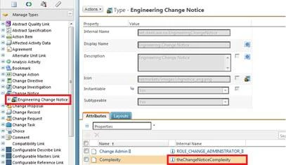

We do this as well - don't use the concept at all but have to satisfy the code that looks for it.
You have to:
- Add Complexity to what the OIR can address in LogicalAttributes.xml
- Fill in a value via the OIR
- Hide it via Type Manager on create / edit / info

Here you go. The key here is knowing how the value is stored in the
database. Its type is string. Therefore:
Pick one value from the enum or update to something not meaningful as
provide as a arg:
<attrvalue id="theChangeNoticeComplexity"&lt;br"/>algorithm="wt.rule.algorithm.StringConstant">
<arg>SIMPLE</arg>
</attrvalue>
Tested on 10.1 M010. No other steps should be required. Alternatively one
could also write their own algorithm class here.
Side note: LogicalAttributes.xml now stored in database table of similar
name. XML file maintained for older code still in system. You can still
configure one or the other.

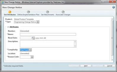

Here is my OIR for my CN soft type where I set "theChangeNoticeComplexity" to COMPLEX but when I start a new ECN it is populated with Fast Track instead of Full Track. What am I doing wrong?

Your first line is wrong, you need to call out the parent object first
<attributevalues objtype="wt.change2.WTChangeOrder2|" net.steelcase.na.engineeringchangenotice=" &quot;=">

Could this be used to set the value to blank? It's crazy that the value is prepopulated permanently (from TS). I get users accidentally selecting the wrong track all the time because they forgot. I've had to hide the OOTB complexity, adjust the OIR like here and simply create my own complexity attribute for use.
