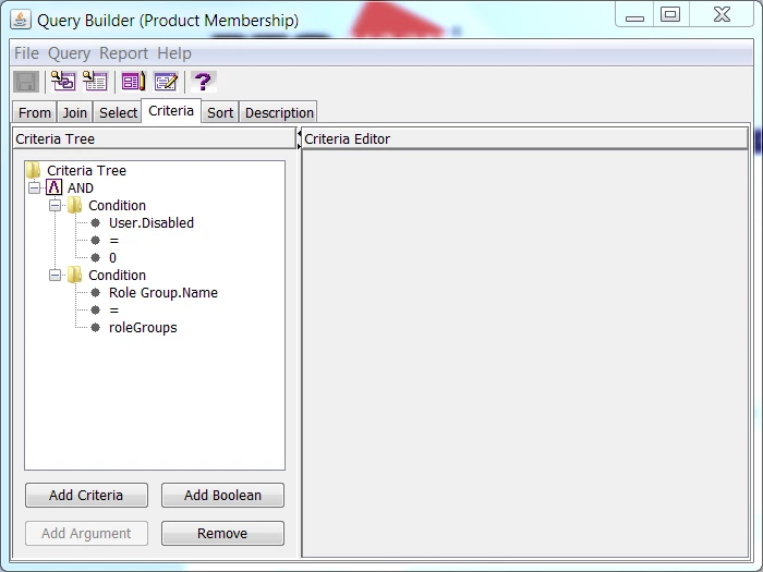

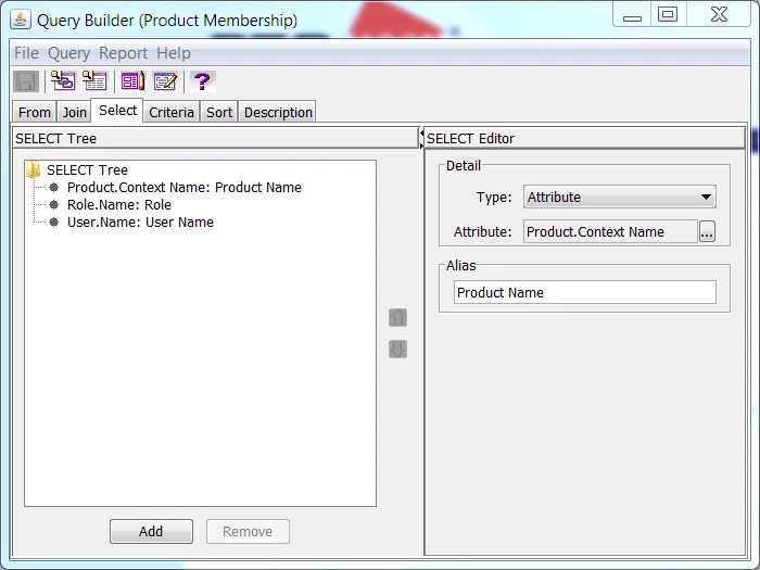

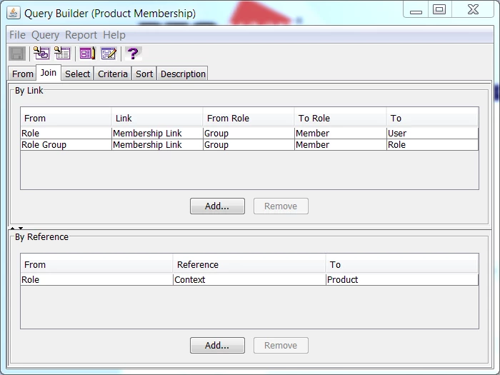

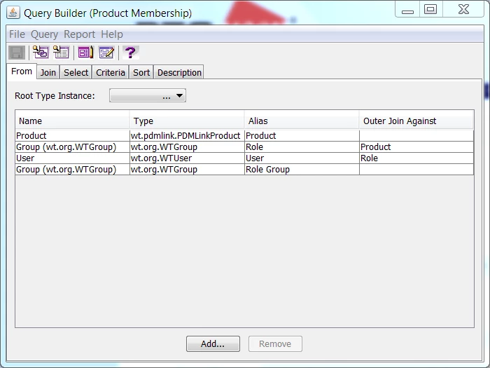

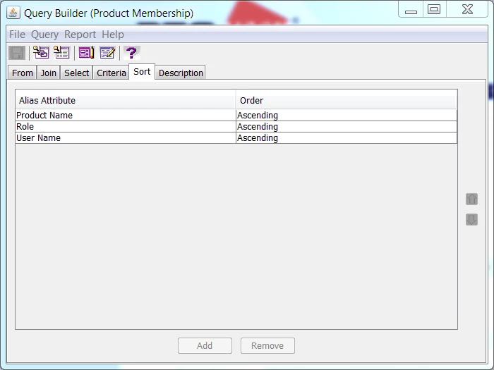

Mike, see attached
Darren

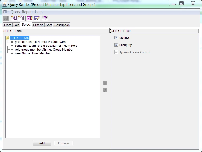

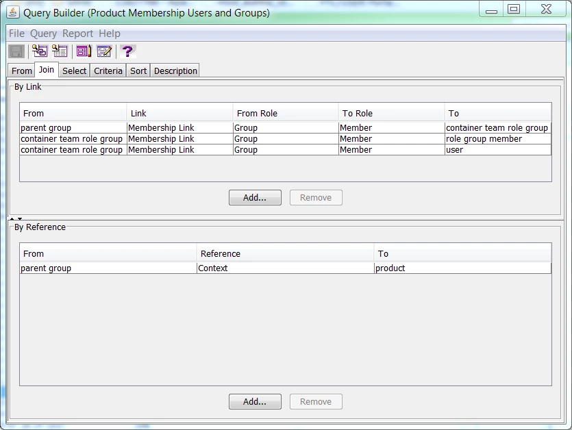

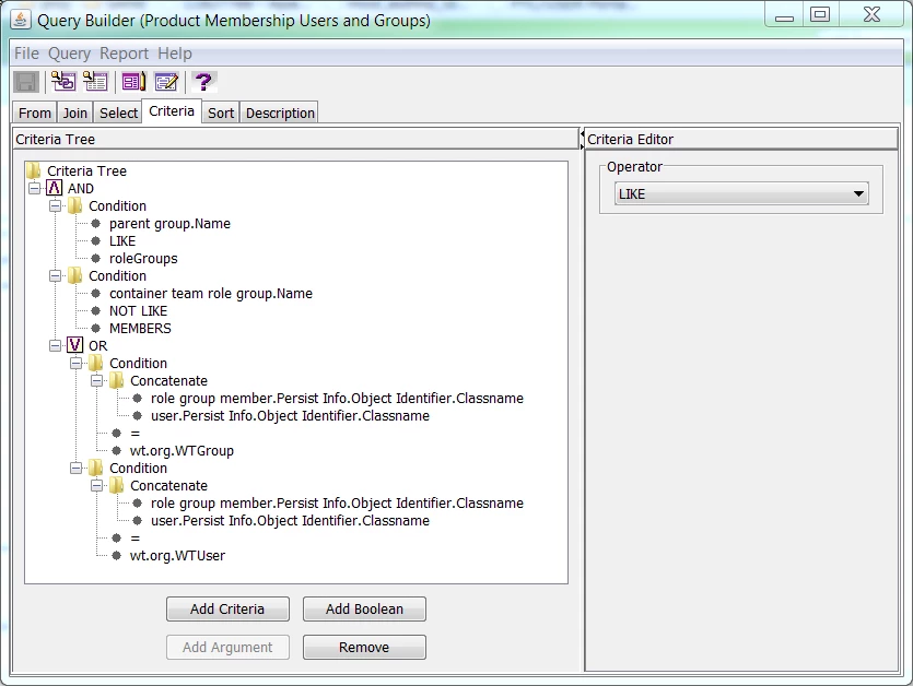

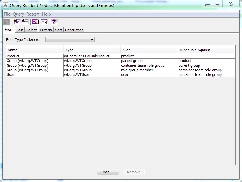

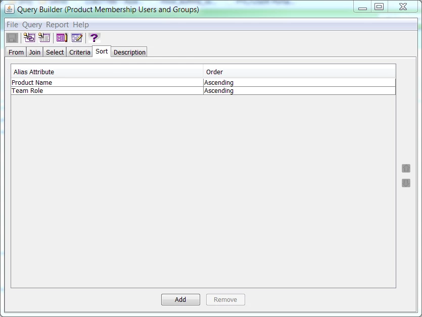

March 8, 2014
Previous report only included WTUser members of the container team roles. Attached is another version which also includes role members of type WTGroup, which exist in LDAP. I also don’t think it is possible to use report builder to determine the members of these groups which are populated within LDAP.
This is not exactly an elegant solution, I can image there is a neater way of doing this.
GUEST role and its members are not included in this report either. The group which represent the GUEST role is in a different position in the group hierarchy to the groups which represent all the other team roles. All the other roles have a common parent group called roleGroups. Didn’t find a way to over come that.
