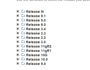

I am finally able to return to this project.I never posted a summary because there is nothing to add that is not already in this thread.
Starting with the correct version is noteasy. As the attached picture file shows, I have quite a choice.
Intralink Release 10,10G 11gR1, or 11gR2. I've downloaded 10 but before I proceed with anything I thought I better check back with you people on this. Thoughts?
Joe S.
22-Sapphire I
January 23, 2012
Download 10.0 for Windchill (select M030). The other choices relate to other modules / applications.
If you use Oracle, use 11gR2 (not provided by PTC). Needs to be installed (software only) prior to installing Windchill.
JOES1-VisitorAuthor
January 23, 2012
In Reply to Mike Lockwood:
Forgive my complete ignorance, but I still do not know exactly what your talking about. The list below shows whatis available to me:
INTRALINK
INTRALINK SINGLE SITE
WINDCHILL PDMLINK
WINDCHILL PROJECTLINK
WINDCHILL WORKGROUP MANAGERS AND GATEWAYS
My license shows "ILINK_CLIENT_License". I am unable to locate anything fits your description: "Download 10.0 for Windchill (select M030)". The fact that I do not know what my upgrade path should be really points to a problem with the marketing folks at PTC. Thanks everyone.
