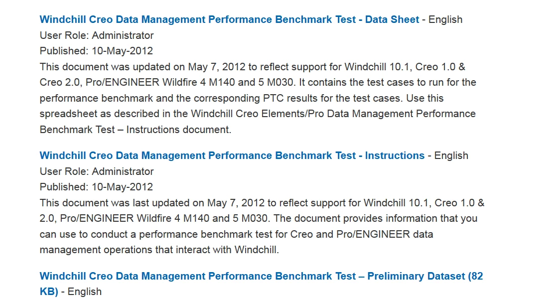

We're looking for a way to test theperformance of our Windchill servers. For example, is our Windchill 10.1 installation slower then our 10.0 installation. Or is the large customization we implemented on our test server too slow to go live with.
We've heard PTC uses (or plans to use) SeleniumHQ tools, but we cant find anyone at PTC whocan verifythis.
Can anyone share info on SelenumHQ and Windchill ?
Which testing tools are you using ?

PTC has Jmeter based load test that uses PTC World Car as a dataset.
It can put pretty nice load on a server and get realistic numbers playing multi users scenario.
Requires some setup on a server side however and also pretty powerful PC to run the test itself.

Igor refers to a benchmark also known as the Multi User Load Generator (MULG). As you can imagine, there is a single user load generator as well. Both are stress tests for Windchill, the first one runs without a ProE client.
We have been using the MULG quiet a lot( assisted by our VAR). But what's hindering us, is our CAD Worker! The CAD Worker publishes anything that's checked in. During the MULG cycle, there is a massive check in. MULG starts deleting those new objects immediately after, but this fails because the CAD Worker already started doing its job. So the MULG fails.
Our actual approach is to disable the CAD Worker on site level, perform the MULG benchmarking, and when finished, re-enable the CAD worker and start a publishing job for those CAD documents checked in and not published. Quiet a burden.
