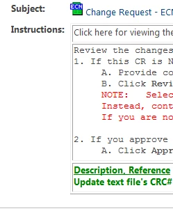

An example of some things that we do for Tasks, using HTML
[cid:image001.png@01CEE1FE.9F4F9A20]

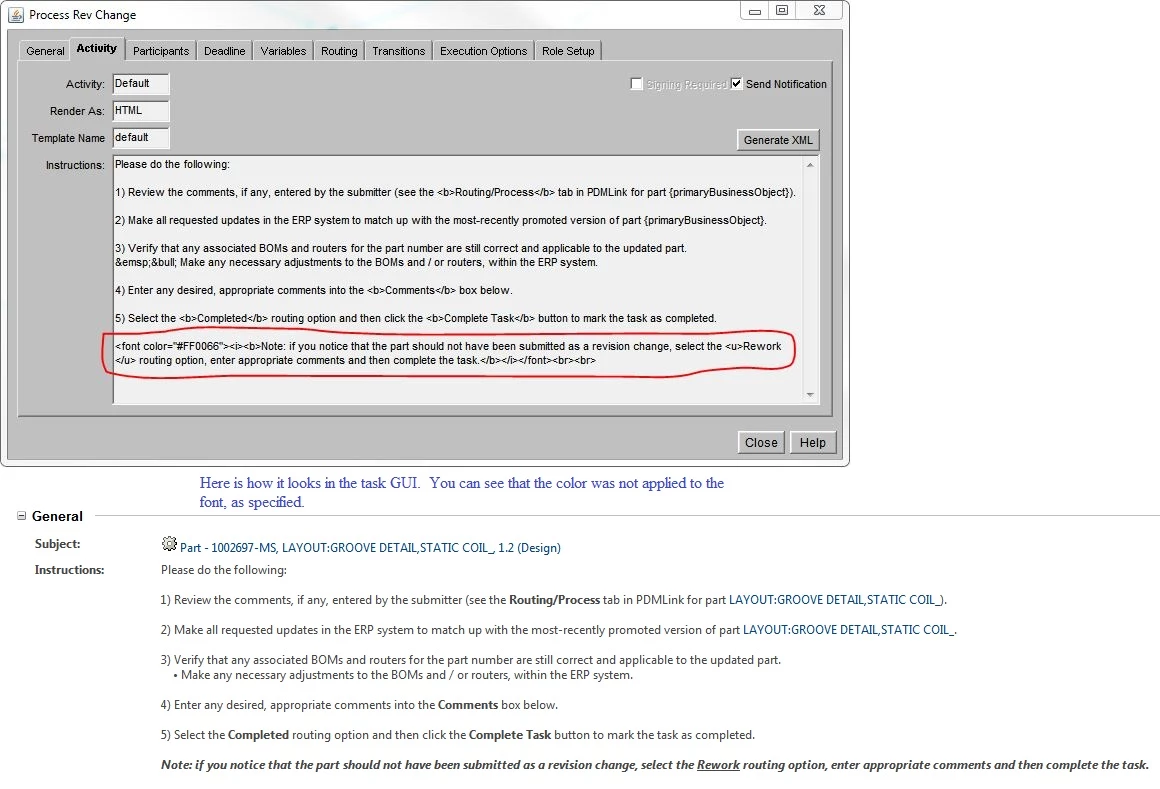

November 15, 2013
Attached is a screenshot of the minor HTML editing that I did in the associated task activity tab. The bold, italics, and underlining work, but the font color did not apply. I have also been able to use other HTML tags like hyperlinks. I would like to do something like was done in the image posted by Mike Lockwood, but I am a novice at this and am not sure how to get it to work. Any tips will be very much appreciated.
