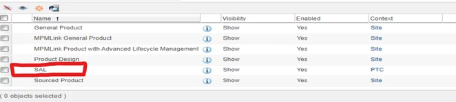

Jun 14, 2024 12:03 PM UTC
Hello @AndrewK
I am trying to load the product template from loadfile utility,
use case :
Step 1: i just export the product template as zip file, from the zip do unzip, we will get the xml file.
Step 2: for the validation purpose, i import that xml file manually from the windchill UI import action, it successfully loaded.
Step 3: I deleted that template which i created in Step 2, and i tried to load that the xml file through load from file utility
command : windchill wt.load.LoadFromFile -d D:\ptc\Windchill_12.1\Windchill\loadFiles\Testing\sup_product\SAL.xml -u wcadmin -p wcadmin -CONT_PATH \"/wt.inf.container.OrgContainer=PTC\"
errror: wt.pdmlink.PDMLinkProduct  cannot cast to wt.inf.container.OrgContainer
[Note :By default at time of importing the product template through windchill UI action it will call ImportContainerTemplateFormProcessor.java ]
Step 4: Now i am trying to pass that xml file from my custom java file [above code] to ImportContainerTemplateFormProcessor.java,   CustomTemplateImporter class  will fetch the .zip after that it has to call ImportContainerTemplateFormProcessor.java with the  .zip file paramater.
i am facing an issue, i am unable to pass that .zip file to the ImportContainerTemplateFormProcessor class.
HelesicPetr
Jun 14, 2024 12:34 PM UTC
Hi @RaikarRaghu
I tried it by my self with OOTB export and it seams that the XML is not suitable to be loaded by load from file utility
Sorry about that.
Try to find OOTB loadable example of templates that are loaded during installation.
they exists in the Windchill location somewhere try to find it and check how the source xml file looks like.
