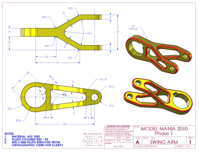

Mar 19, 2018 6:34 PM UTC
Solidworks Model Mania Challenge from 2010.  the Original and Revised drawings of the 2017 Battle Royale look eerily similar to the Phase 1 and Phase 2 models from the 2010 challenge in SW.
