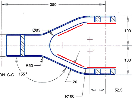

Continuing the feature count discussion, when I built this at the show I was torn on whether everything in this view should be sketched together or if the inside area (along the red lines) should be done as a separate feature.
Based on the way it's dimensioned, if you really want these dimensions to be the "real" controlling (think shown) dimensions, you are forced to sketch both the inside and the outside at the same time.  If instead of the R100 the designer had called out R120 on the outside of the part, the inside area could have been created completely separate from the outside.
These type of modeling decisions can definitely impact how easy the model can be changed in the future.  I know that for the final championship round they were going to give each of the finalist their original models back and then require them to make certain changes.  I didn't get a chance to see it but maybe Toby Metcalf‌ can get a copy of that final print too.  It would be interesting to see if any of the initial modeling decisions end up causing trouble later.

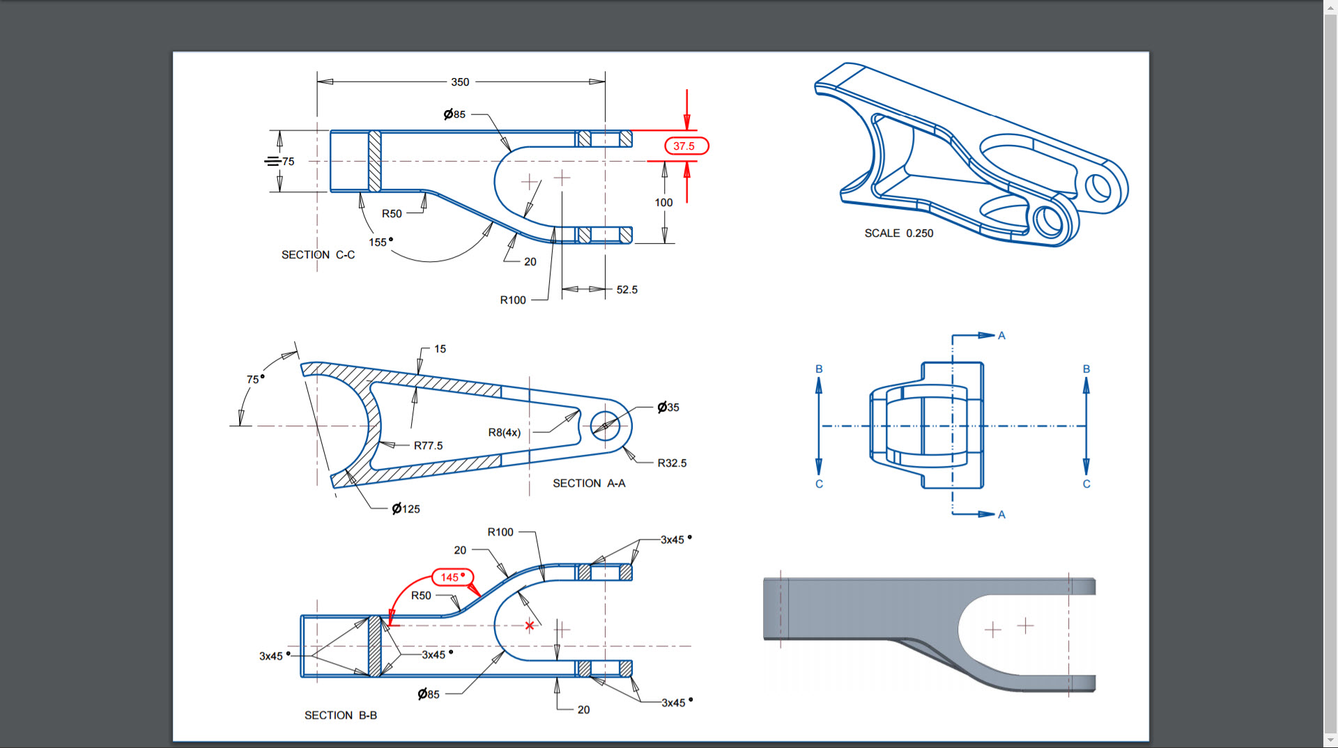

Jun 9, 2017 2:08 PM UTC
TomU
Jun 9, 2017 2:52 PM UTC
Interesting.  Thanks for finding this.  Knowing this, does it change the approach anyone would have taken on the initial model?
