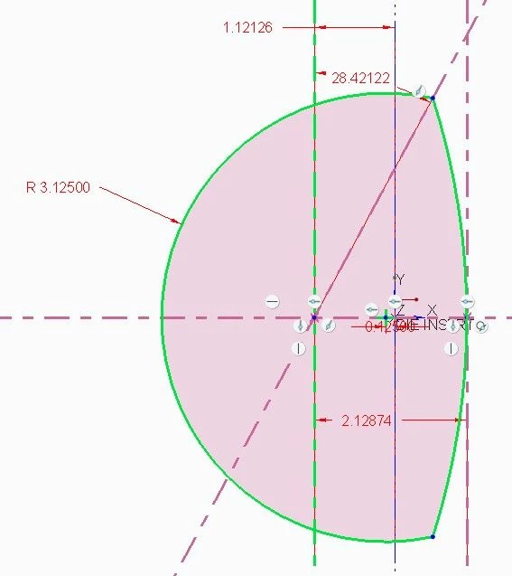

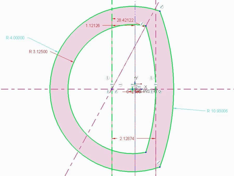

I would like to be able to offset a curve enclosure inside of a sketch and observe the change's relation to the geometry outside of the sketch.
Is there any way inside of a sketch to use the offset option and have the offset recognized as a offset instead of the resulting geometric features created from the offset?
Below is my simple sketch prior to the offset.

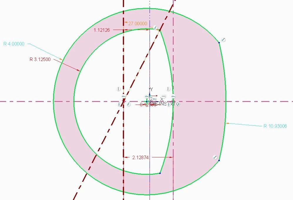

Below is the application of the offset.  Notice that the offset is recognized as 2 weak radii shown in light blue.  This applies as it should.
The problem is that if I modify any of the strong dimensions the needed offset is no longer uniform.  (Below I modified the angle value).
Perhaps in this specific example it would be possible to modify the constraints to get the needed offset with the change, but in a more complicated sketch I would like the option to have my offset features retained as a offset as I have intentions of having this update appropriately with the downstream extrude within a family table.

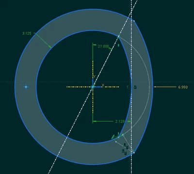

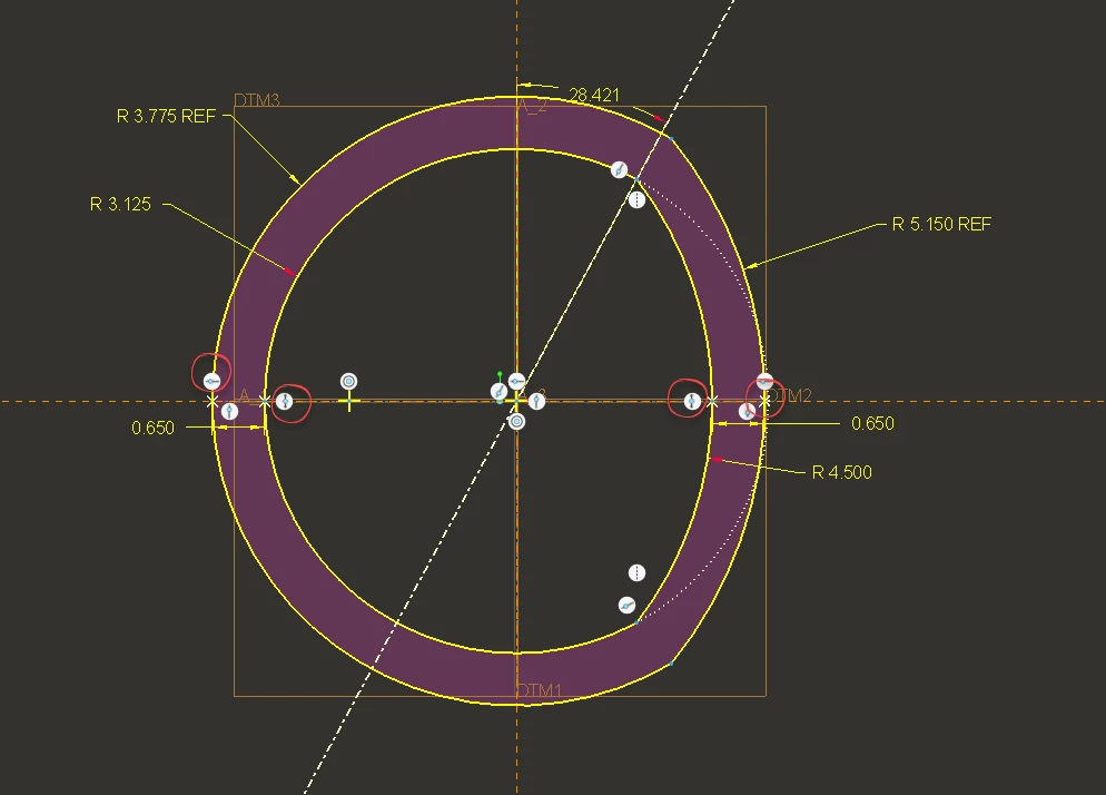

Getting the sketch constraints to support this is the trick. This is not the only way to get a solution, one example.
This example Creo 7 model enclosed will support your goal but does not use the offset function exclusively. There is a part parameter SK_OFST1 that is used to define the offset value and this parameter is used in feature relations driving the sketch along with constraints that ensure the offset behavior is enforced. These are datum points at the midpoint of each arc being offset with a linear distance between them. These linear strong dims control the offset within the sketch via the feature relations. The user can change the offset parameter value and regenerate the model without entering sketch mode.

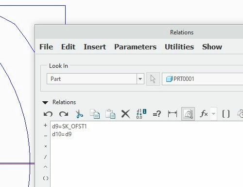

I could see that both .850 dimensions in your sketch were relation driven.
I am new to this style of relation so I have a couple questions.
1) To build the cooperative number between d9 and d10 do you just build this relationship by typing in these names and the = sign?
2) Is the SK_OFST1 value actually functional or is it just a name that could be used downstream in a family table to give name definition to the needed offset value?
Thank you,
Paul
tbraxton
Jun 20, 2023 4:27 PM UTC
1) The feature relations for d9 & d10 were manually typed in the relations editor including the = sign.
2) SK_OFST1 is a model parameter and is functional it is used in the relations to set the offset value. You can see this parameter using the parameter editor by using: Tools-> Parameters.

I tend to use perpendicular construction line segments + the equal length constraint in order to implement the design intent in these cases:

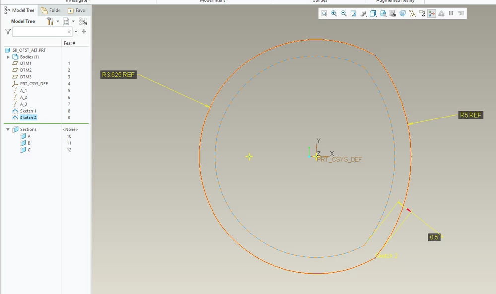

Jun 20, 2023 4:36 PM UTC

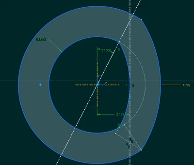

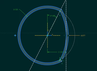

Here is an alternate solution using two sketch features and the offset loop functionality. This does not require any relations or parameters and allows for modifying the offset value without entering sketch mode. This is the simplest implementation I can think of to capture the design intent. Sketch 2 is offset from sketch 1. The offset is controlled by a single dimension in sketch 2.
Creo 7 model enclosed for reference
