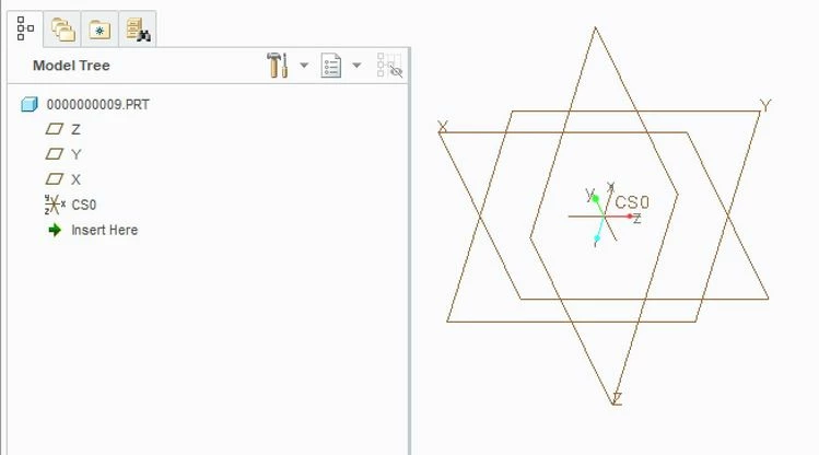

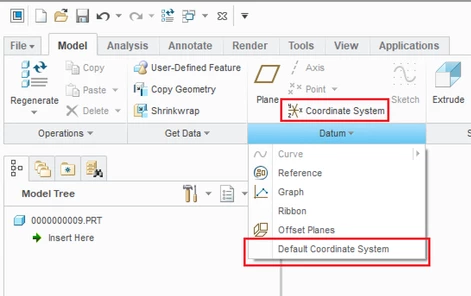

There are two types of coordinate system features in Creo - the normal "Coordinate System", and the "Default Coordinate System".  Creo reserves this internal "Default Coordinate System" - that always set the same orientation.
Basically, Creo always needs something to use as a reference. So, the first feature in your tree can either be:
  • a "default" csys
  • three datum planes
If the first feature in your model (or your "start part") is a coordinate system - it will actually create a "Default Coordinate System", because there is nothing else in the part to use as a reference.

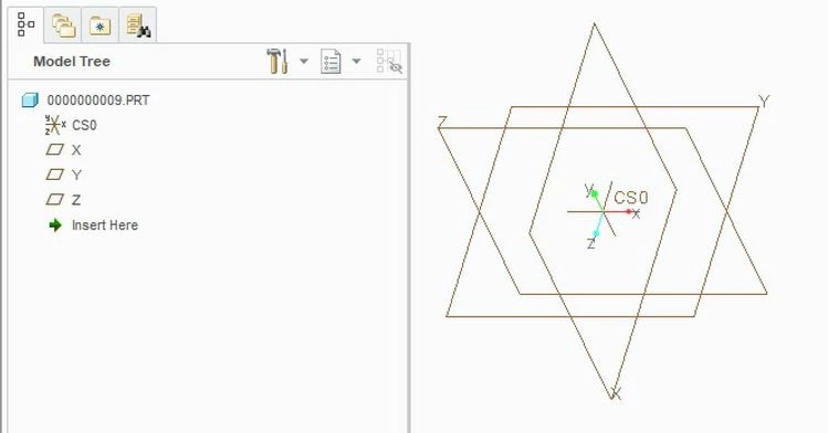

If you want your start part to use a coordinate system with a different orientation, you can define your datum planes first, then create a regular coordinate system to orient  it differently.
aka - if you create your "coordinate system" (and then three datum planes), you will get this:Capture.JPG
If you create your datum planes first, and THEN your coordinate system, you can create something like this as you desire.rotated.JPG
Note how the blue-green-red are matched to different axes than in the first example, and I've simply renamed the datum planes.
However, a VERY important thing to note: even if you create your "first" coordinate system as I showed in the second example.... if you create a "Default Coordinate System" now, it will ALWAYS create it with the same orientation as in example 1, and you will not be able to edit it's definition.
If you ever want to "change" the orientation of the part... one thing you can do is to create a NEW coordinate system rotated from the "Default". Then you can use "Replace Reference" to  change all of your features to use the new coordinate system/orientation instead of the old default one (then maybe hide or delete the default... of course, depending on your company standards, etc).
Hope this helps!
