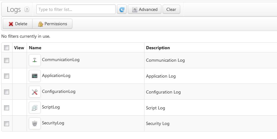

Is there anything in your application or security logs on your server?
Right now it still looks like your server may be configured to not permit this call.
Jun 27, 2016 2:18 PM UTC
Hi Bill,
Thanks for getting back to me. Quite strange - I'm logged in as 'Administrator' but I'm unable to access the logs....
I've checked on my local VM and I can't access them there either - am I missing something here?
Pete

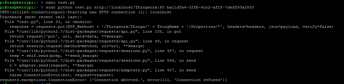

billrei12-AmethystAuthor
Aug 18, 2016 8:20 PM UTC
It looks like you are trying to connect on thingworx on your local machine. There is an error in your connection URL. Try http://localhost:80/Thingworx . Also try http://localhost:8080/Thingworx as this is the default port used when you first run ThingWorx.
Aug 18, 2016 8:25 PM UTC
Thank you for your help. I replaced localhost with the IP address of my local machine and that worked! Thanks Bill Reichardt​
