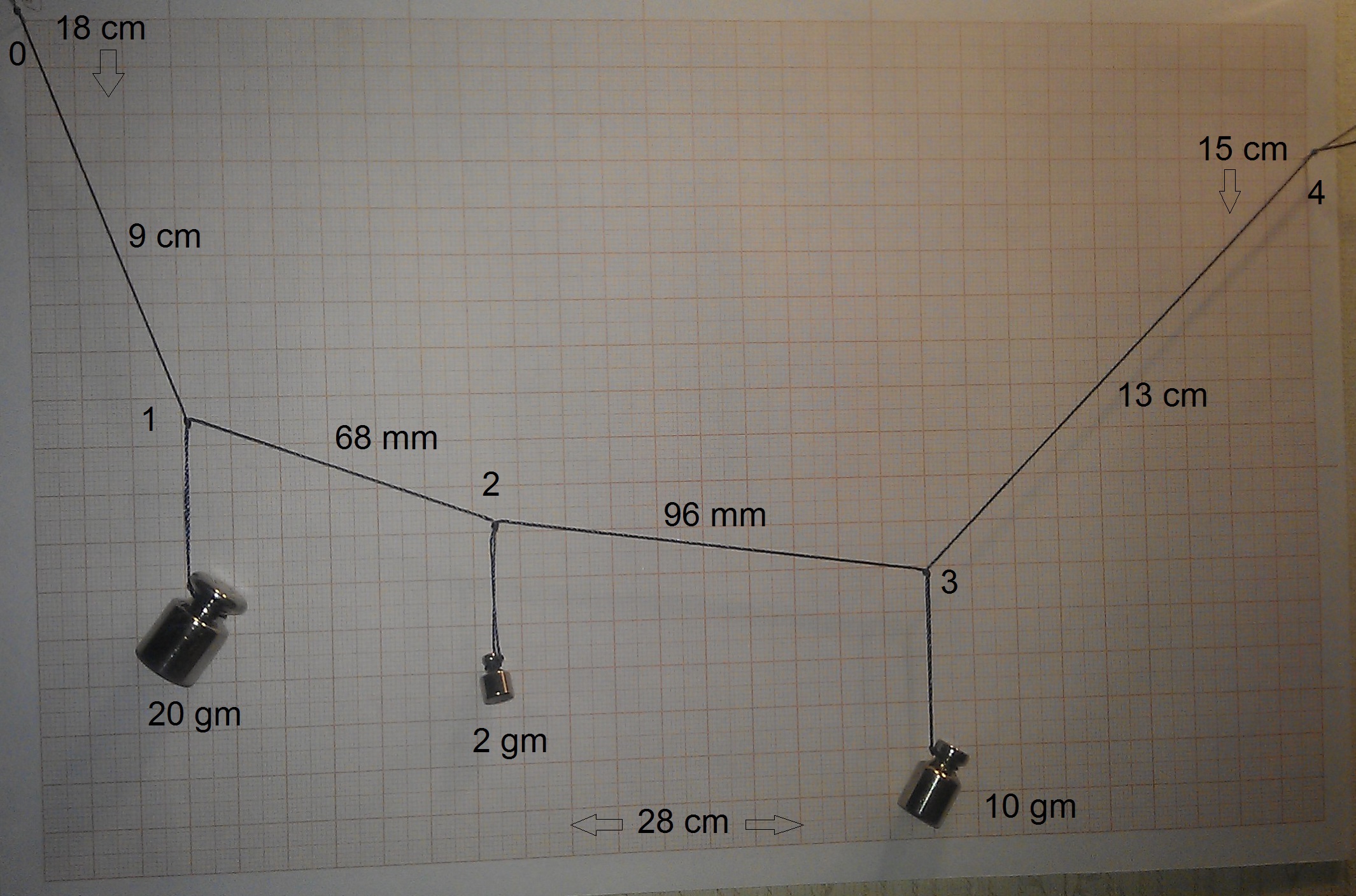

I try to find forces in this task. The Mathcad 15 sheet is in attach. Are equations in the Given-Find block right?
What is the 8-th equation?

The horizontal forces at the walls don't have to be equal, and
the force vector has to align with the string
April 12, 2017
If they're not equal, then the system is not static.  Those two forces are the only horizontal forces acting on the system, so they must cancel out.  Note that your solution has the two forces very close to each other.  Remove the negative from your RHS (Valery has defined F0x as acting in the opposite direction as F4x) and re-enable evaluation of that region and your final result is pretty much unchanged.
April 12, 2017

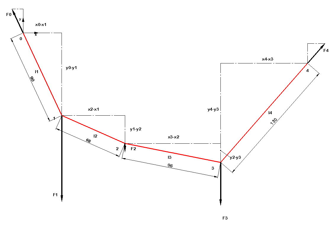

The reactions at 0 and 4 must be in the direction of the string.
For example:
(negative required due to how your variables are defined)
You can write a similar equation for the forces at point 4.
Also, you can balance the forces in the X direction at points 1, 2, & 3, and you can balance the forces in both the X and Y directions at points 0 & 4.  Some of these equations will likely be redundant (what's the mathematical term for this?).
23-Emerald I
April 12, 2017
The horizontal forces at the weights are equal (for static equilibrium.)  The walls are fixed, so there is no requirement that F0x and F4x be equal in magnitude.
Yes, I was sloppy in directions so I needed a negative sign.
April 12, 2017
Fred,
I agree the walls are fixed, but look at the string.  It has 5 forces acting on it.  3 of those forces are vertical (points 1, 2, and 3), so the horizontal components of the other two (0 & 4) must be equal and opposite.

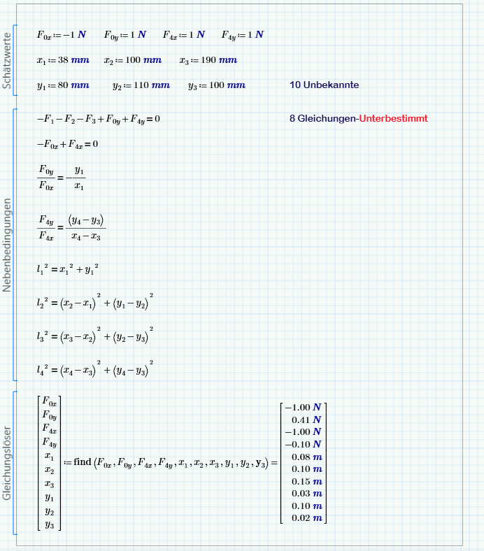

What about bringing the geometrical relationships (Phytagoras) into account like that:
My problem is: I'm missing 2 Equations for the complete solution.
10 unknown and only 8 EQ.
btw.: The Force F4x should be positive.

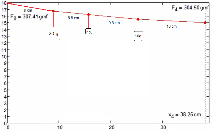

...It seems to be that there is a solution:
April 13, 2017
Ohne die Minimize Funktion?
April 13, 2017
Do we really need a minimize function if we have 10 conditions and 10 Equations?
If yes, how does it works in a solve block?
April 13, 2017

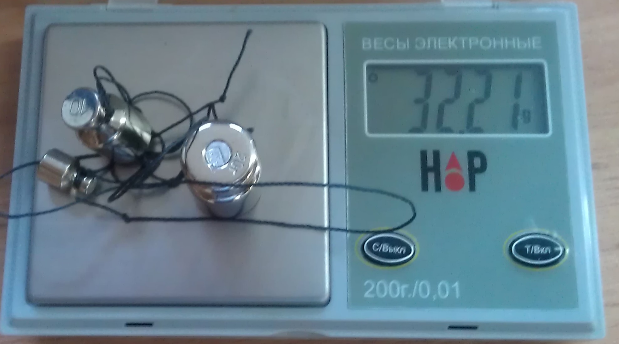

See please mass of bobs and mass of string
April 13, 2017
there are left 0.21 gramms for the string.
makes 0.65% deviation.

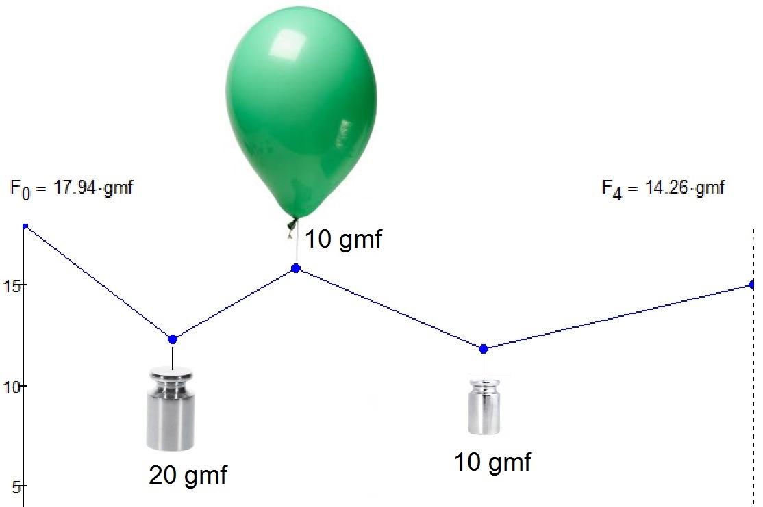

Is this model true? Can we use the minimize function here?
April 18, 2017
Valery,
...to be serious
you changed the Geometry: Value x4 from 280mm to 340mm. Why? (better to compare with 280mm to the former problems/situations)
Setting up the 2.nd mass from 2gm to -10gm (now it it a Force upwards) doesn't (may not) corupt the Energy-Laws, so the use of the minimize-Method is in my opinion ok.
The minimal Princip of the potential energys is given by m1, m3.
