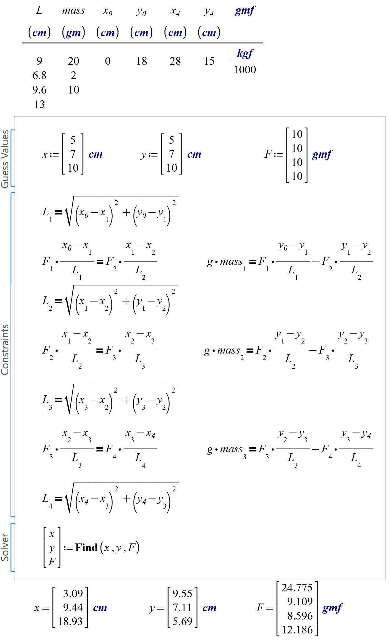

One task with 3 bobs - Forces searching
I try to find forces in this task. The Mathcad 15 sheet is in attach. Are equations in the Given-Find block right?
What is the 8-th equation?

But no solution in Mathcad 15 - different units in vectors! Do you know solutions?
When i change the guess-values, the results change or an error occurs.
The Method with minimize function is stabil at all.
Volker! Guten Morgen!
Sorry - I have do it and get stabile results.  In Prime. Show please the picture or pdf!

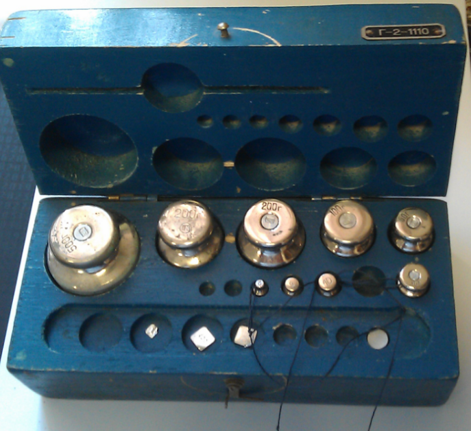

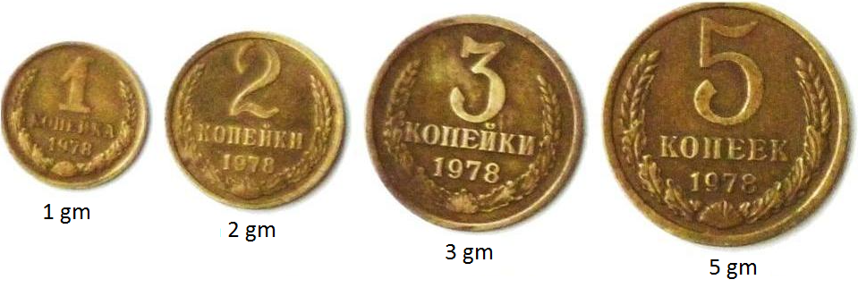

How is the process of translation?
Here's what I found in my desk drawer
Soviet coins we can use too for it
