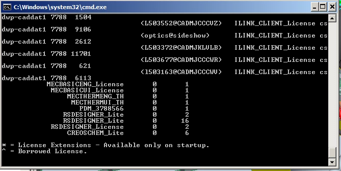

ptcstatus in a command prompt.
You just have to set a 'Path' system variable to point to the correct folder (<loadpoint>\Creo 2.0\Parametric\bin)

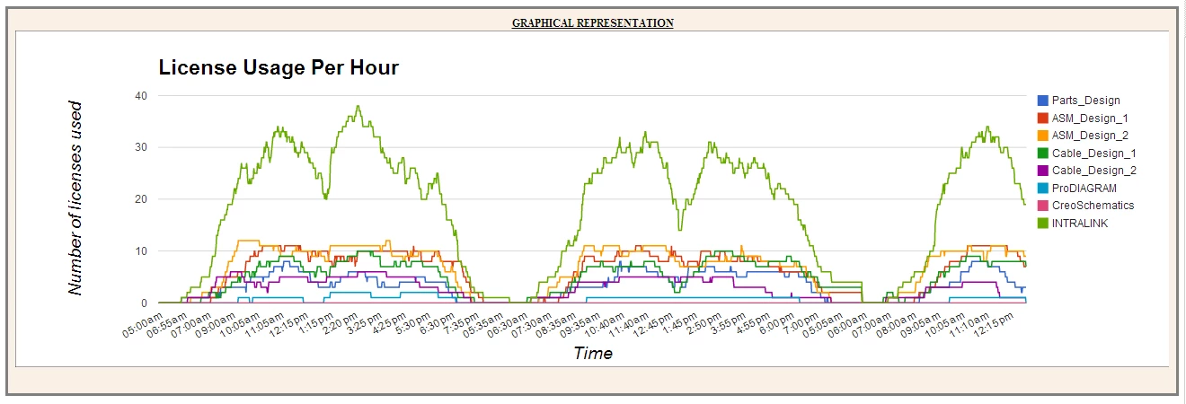

with the ptcstatus, we modified one line of code and then the intern made a
sql based local site showing the status: we list each user by name and what
license he/she is using on a table above this graph. I can't show it
because it has the names of our users. I renamed the licenses so people
won't jump to Flex3C right away like it used to happen.

server head just the good old ptcstatus with a single line removed mod:
[image: Inline image 1]

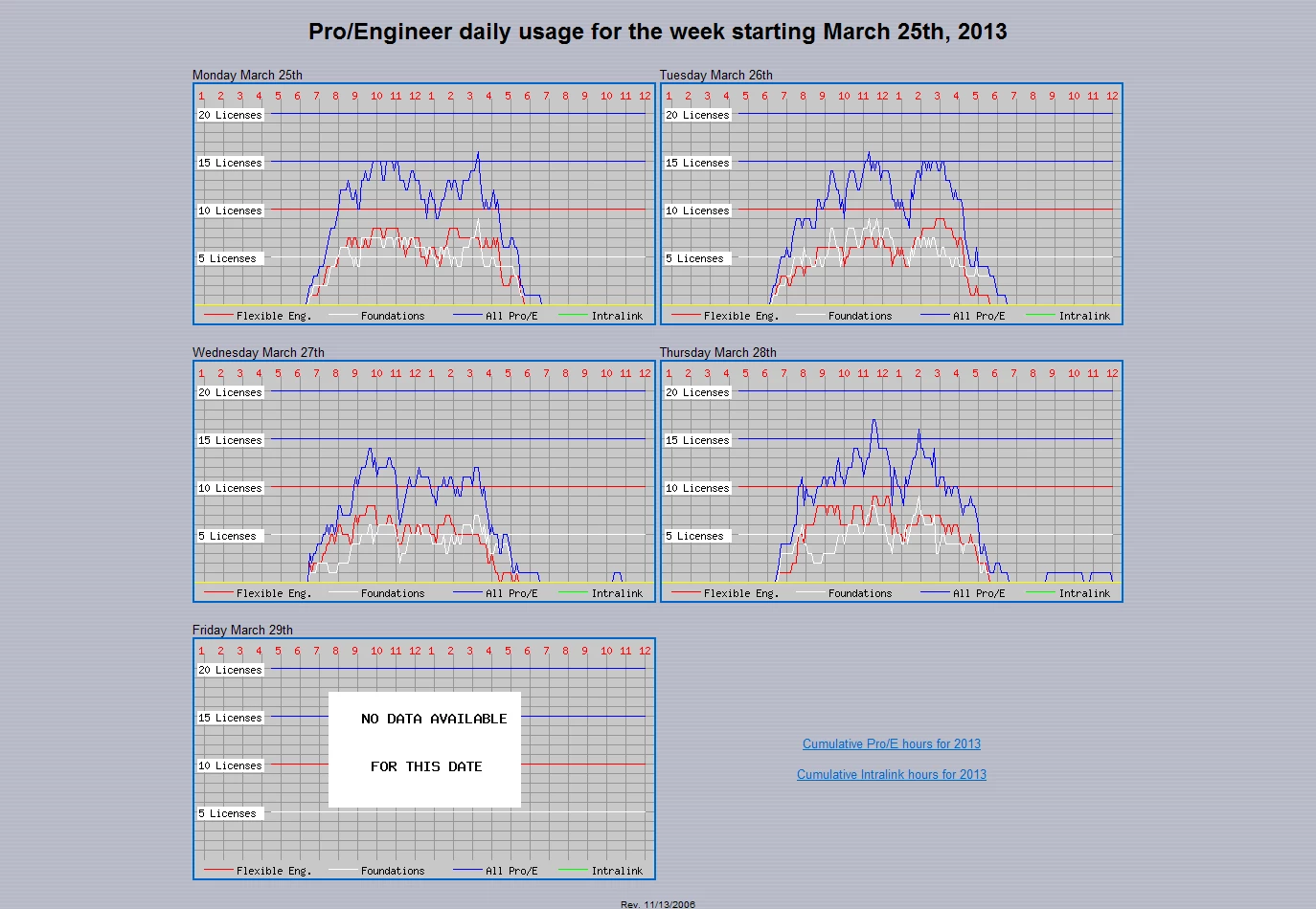

the page looks like this:
[image: Inline image 5]
The red items are open licenses available. For the ones we have few of we
list each, for the intralink license we have a single red entry that says X
number available.
The code is simple, but would probably require like an hour or two to make
it work in someone else's machine/network/business. It was a nice intern
project that we probably need to re-write, but its so simple that we
haven't had a want/need. The users load via sql using a CSV table from
excel.

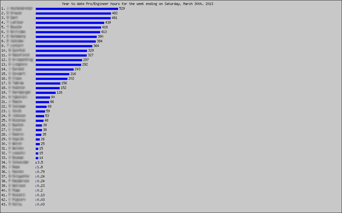

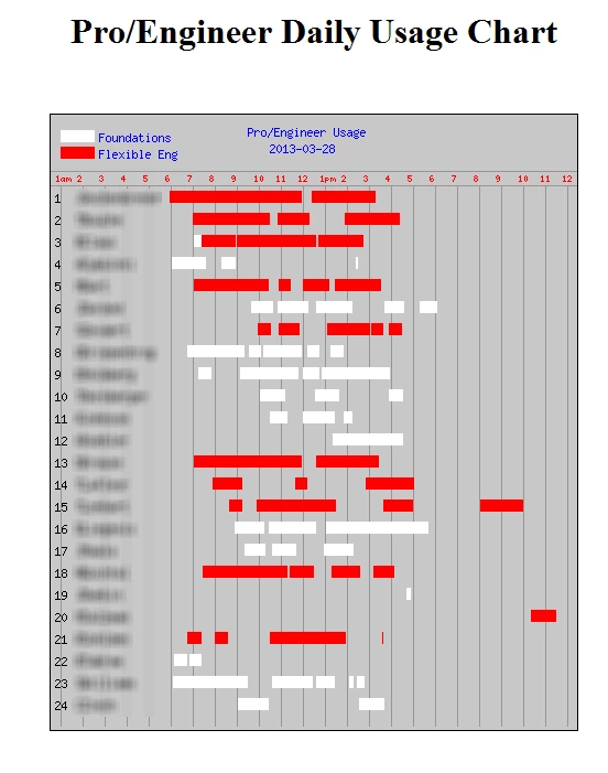

We use a perl script that I wrote about 10 years ago that strips the user, licenseand start and stop time information out of the log fileand then pushes the data into a MySQL database. We look at the results on some web pages using php's GD image library. All the graphics are generated on the fly. The images that it creates are a bit dated looking. I haven't played around with any of it for years: it's simple &just works..
It's not perfect but it gives us a consistent record of who uses what and when.
We originally started recording login times backin the early 90's when our company bought a bunch of SGI unix workstations each with a seat of Pro/Engineer for $30-40k a pop and our CEO wanted to make sure we were using them after spending all that cash (even wanted 2 shifts, which was impractical and thankfully was never enforced).
