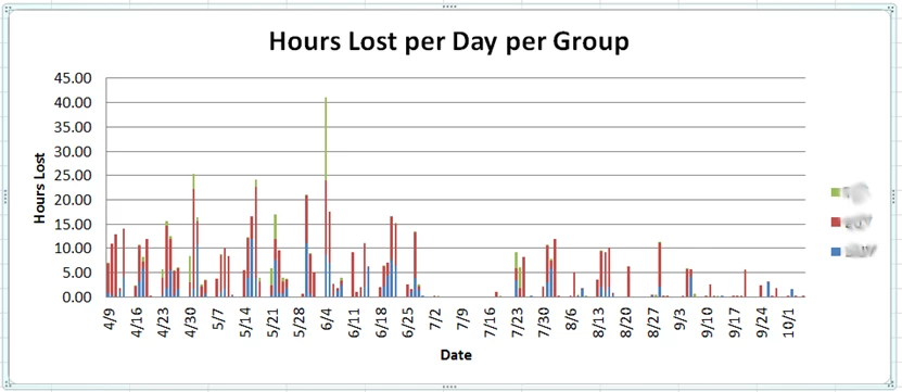

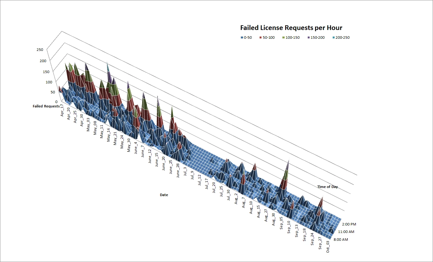

I set the log flag on all users and collect the logs separately The logs
give feedback as to how many users per day failed to grab a license of
what. But I haven't had time/chance to figure out a
graphical representation that would help in the getting more licenses
scenario. Its almost necessary to show it terms of money/opportunity loss.
This is what I came up with using some perl to process the logs and export
something in terms management can understand. I will be adding this to our
site as a management only view. Excel sucks at everything, even graphs so
that's why I asked my intern to use the google graph system - html 5 piece
of code. She figured that out quickly and get our little graph done. These
are excel:
[image: Inline image 2]
[image: Inline image 1]
note how one day we got licenses Smiley Happy then we got more users again....then
more licenses and we figured a license to user ration that works for our
dynamic. so our efficiency should have gone up.
when the users were fighting for licenses it was horrible. None got to work
on their project without getting interruptions.
