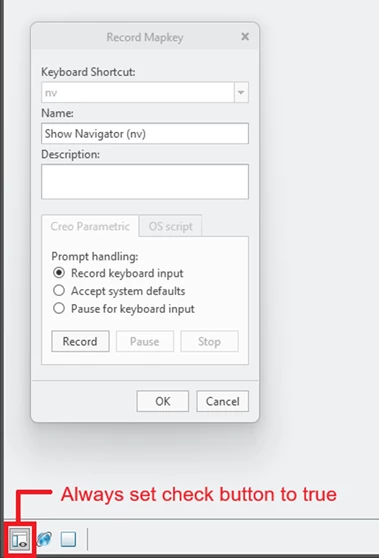

Sometimes you need to get input from users before continuing. You can change how the mapkey records input, but I haven’t played with this too much.
I usually just leave it at the default and add code in as needed. The two commands I know about are @MANUAL_PAUSE and @PAUSE_FOR_SCREEN_PICK. @MANUAL_PAUSE lets you tell users what they’re supposed to do but make sure you tell them to RESUME and not click any Creo menus as needed. Sometimes you need a @MANUAL_PAUSE with @PAUSE_FOR_ SCREEN_PICK.

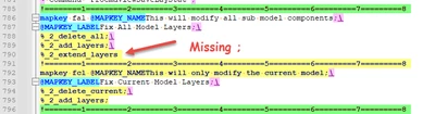

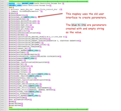

I decided to make a language file specifically for editing mapkeys. The xml is attached.
I wanted to high light key components of the language so that the actual mapkey syntax itself is not hi-lighted.
This allows you to see if your missing:
  • the ending character for a command,  ;
  • A line continuation, \
    • These two errors would be the most common failure mode when your manually modifying a mapkey.
And it hi-lights key components of mapkeys like:
  • The starting character for each individual command, ~ and #
  • Other mapkeys that run
  • Comments – full line and in-line
  • MAPKEY_NAME & MAPKEY_LABLE
  • Mapkey Pauses
  • System calls to a batch file
  • Paths to files called in mapkeys

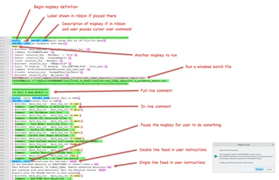

Examples
Here is the first example of what it hi-lights.
Here is a second example of hi-lighting
Here is an example of the hi-lighting showing poor syntax on a mapkey that still works, but doesn’t have an ending ;
This lets you see where the syntax should be manually fixed.

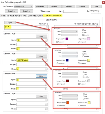

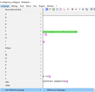

Making your own language
In case you want to know how to create this:

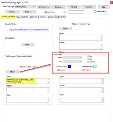

From the language menu, pick:
  • User Defined Language
  • Define your language…
In the new dialog box pick Create new…

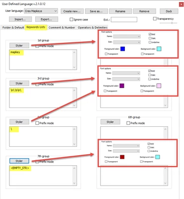

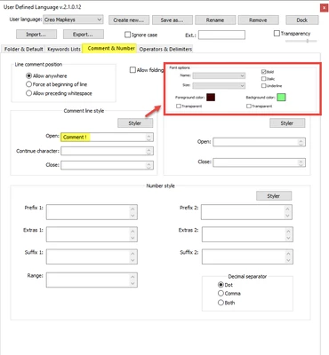

Here is how I’ve defined the language. Starting with the left tab and working to the right
Enter the yellow hi-lighted strings and then pick the Styler button to set the font color and background color.
  • You could also change the font face and size if wanted. I’ve selected just Bold for all these. By default it selects all three check boxes.
Folder & Default
Keywords List
Comment & Number
Operators & Delimeters
Delimiter 5 characters are:
  • Open = colon after the Drive letter,
  • Close = apostrophe at the end of the file name. before the semicolon command ending character.
To save the file, pick Export…
And browse to where you want to save it and give it a name.

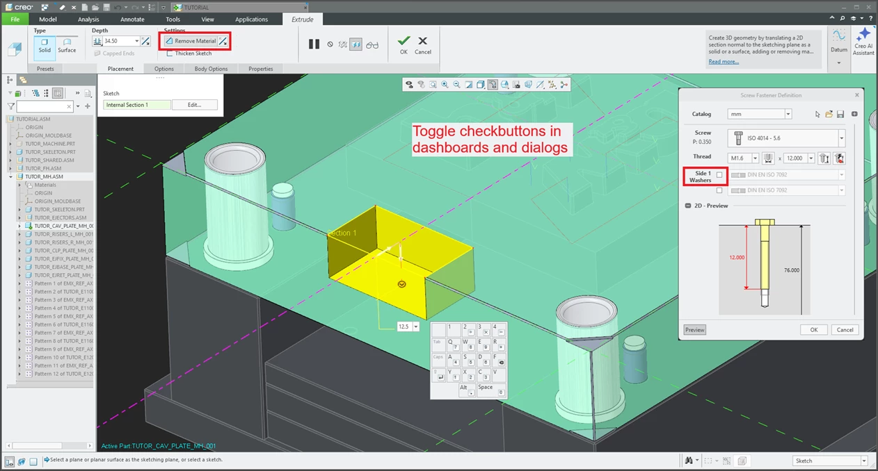

Some great mapkey tips collected here. I thought I'd add my two cents, though it should be said up front that editing mapkeys and trail files is not supported by PTC.

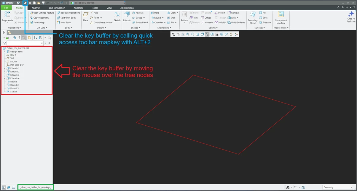

1. Clearing the mapkey key buffer
Every mapkey user knows how annoying it is to mistype a mapkey. There are several ways to clear the key sequence shown in the message area: press Enter, delete it with Backspace, open the RMB menu, move the mouse cursor into the model tree, etc.
That last one is, as far as I can tell, not widely known among Creo users. Whenever I need to clear the key buffer, I flick my mouse left and right, so it briefly enters the model tree and comes back to the graphics window. Hovering over nodes in the model tree always clears the key buffer.
Another way to clear the key buffer is to execute any command. If you have mapkeys in your Quick Access Toolbar, you can still run them via shortcut even when you've just half mistyped a key sequence. In my case I press Alt+2 (do not wait until the key tips show) to run mapkey
~ Command `ProCmdUtilMessageEmpty`;
which clears the message area and, with it, the key buffer.

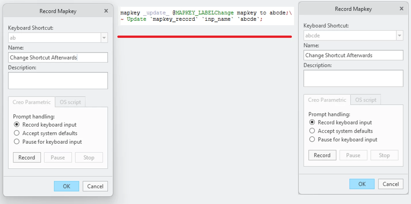

3. Changing the key sequence of recorded mapkeys in session
When you open an existing mapkey with "Edit…", you'll notice that the field below "Keyboard Shortcut:" is disabled, which suggests you can't change the key sequence after the fact.
The trick to changing it anyway is rather simple: use a mapkey. Open the trail file of the current session and watch it live. When you record a new mapkey, you can see the name of the dialog (`mapkey_record`), the name of the input component (`inp_name`) and the shortcut text you entered (`abcde`):
~ Update `mapkey_record` `inp_name` `abcde`
If you have a saved mapkey that runs exactly this line, you can edit the keyboard shortcut of another mapkey in that field, even though the component is disabled in the dialog. Click "OK" afterwards and the key sequence of that mapkey is changed in session.
Obviously, you could simply reload your entire mapkeys.pro file to update your mapkeys, but this mechanism becomes important in the next point.

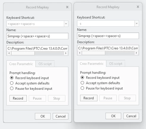

4. Using the space bar in mapkeys
If you try to record a new mapkey with the shortcut `a b`, you'll get the error message "Mapkey key sequence cannot contain spaces".
The trick to using a space (or several spaces) anyway is to insert a placeholder and then use the mechanism from point 3. I usually record shortcuts like `a<space>b` and afterwards convert the key sequence to `a b` by running a trail file/mapkey. There is a catch though: you cannot save mapkeys containing a space, since Creo trail syntax is generally whitespace-insensitive.
So, at the start of each Creo session I run a trail file (.txa, called via a mapkey) which converts all my stored `<space>` mapkeys in session. The trail file opens the mapkey dialog, selects each `<space>` mapkey and edits its shortcut:

~ Activate `mapkey_main` `ModifyButton`
~ Update `mapkey_record` `inp_name` `x `
~ Activate `mapkey_record` `OkButton`
~ Activate `uit_cmd_conflict_msgdlg` `yes`
~ Activate `UI Message Dialog` `yes`
~ Activate `mapkey_main` `CloseButton`
~ Activate `unsaved_mapkeys` `yes`
Of course I don't write the conversion trail file cs_convert_space_mapkeys.txa by hand; a script generates it automatically from my mapkeys.pro.
5. Toggling check buttons in dashboards and dialogs
If you record a mapkey that sets a check button in an open dashboard or dialog, you'll end up with a mapkey line that captures the UI state at recording time.
Set the check button always to true (=1) in a dashboard/dialog:
~ Activate `main_dlg_cur` `maindashInst0.remove_material_cb` 1 ;\
Set the check button always to false (=0) in a dashboard/dialog:
~ Activate `main_dlg_cur` `maindashInst0.remove_material_cb` 0 ;\
But what I usually want is a mapkey that toggles the check button. The trick is simply to remove the 1 or 0 from the mapkey line:
~ Activate `main_dlg_cur` `maindashInst0.remove_material_cb`;\

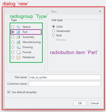

It actually took me a while to realise that every line with a UI action is structured in exactly the same way. The scheme is always:
~ Select `relation_dlg` `ParamsPHLay.ParTable` 2 `rowBUW_PROJECT_SHORT` `name`
~ <action_name> `<dialog_name>` `<component_name > ` 12345 `<optional_item_name> ` `<optional_cell_name>`
The names make it fairly obvious, but people sometimes misunderstand the selection array size (the 12345 above). Examples: if you click a radio button, this number will always be 1:
~ Select `new` `Type` 1 `Part`
because in the dialog named `new`, the radio group named `Type` only allows 1 single selection – here the radio button named `Part`.
If you select five nodes in the model tree, the selection array size is 5, and the trail line then lists all five node names.
~ Select `main_dlg_cur` `PHTLeft.AssyTree` 5 `node12` `node11` `node10` `node9` `node8` 1

10. Mapkey to always show the navigator (Creo 13)
Some commands in Creo do toggle the visibility state of UI components. In case of datums like planes, axes, points, csys you have a config option you can change in the options dialog to set them to a defined state. Others like the model tree navigator have no config option available and thus they toggle with every call of a mapkey.
The trick to set the navigator to be always visible with a mapkey: Toggle the state, then read and evaluate the last line of the live session trail, then run a one-line trail file to toggle the navigator again if necessary.
! Replace “C:\\startup\\trailfiles” with your trail_dir directory.
mapkey nv @MAPKEY_LABELShow Navigator (nv);\
~ Command `ProCmdNavigatorBtn`;\
%_Command_WriteShowNavigatorTxa;\
%_Command_RunShowNavigatorTxa;

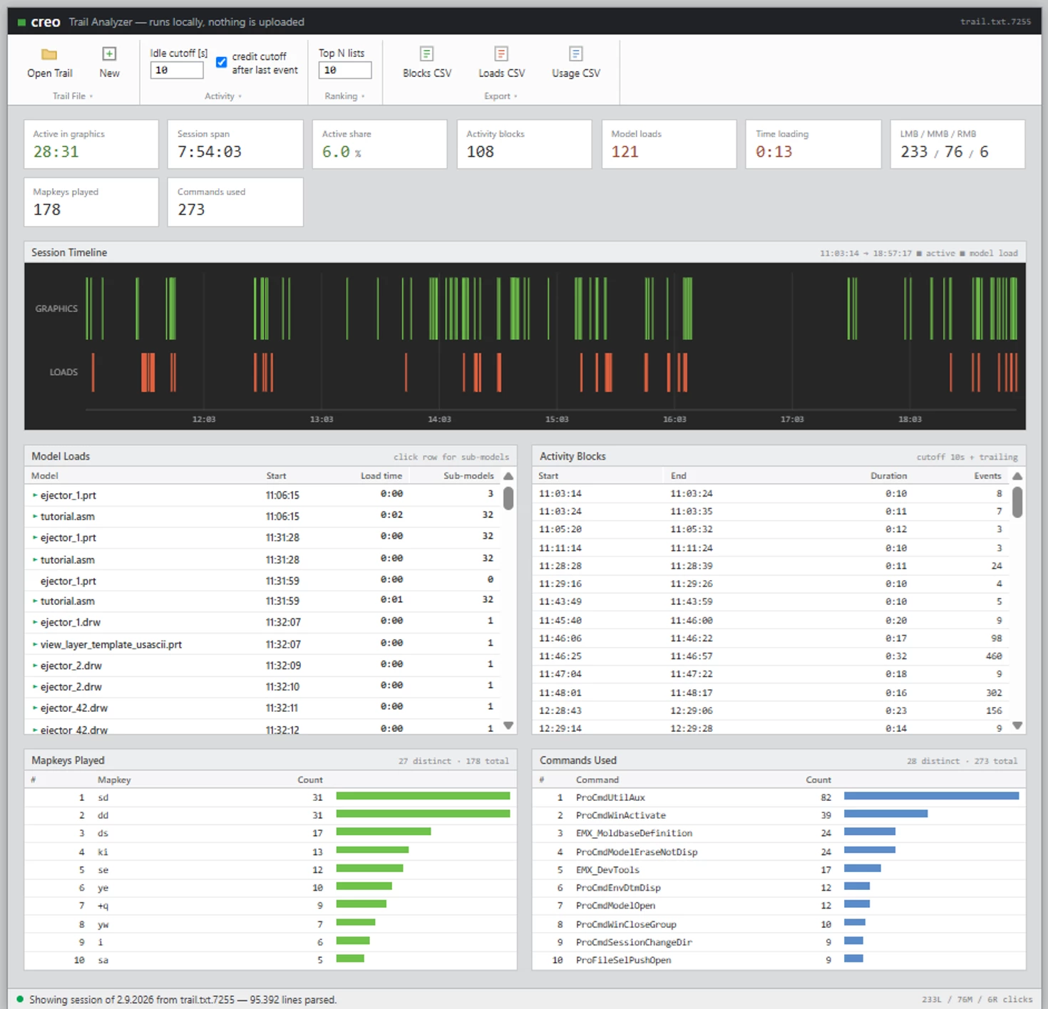

11. Statistics from the trail file
Since every trail file states its start time in the header, you can take advantage of the fact that every mouse click comes with a timestamp. I use the trail file analyser to visualise the stats, simply by dragging and dropping my trail files into it:
  • How much time did I spend in Creo over the day? (as a toolkit developer I have Creo running, but I spend most time in the IDE)
  • How long did it take to load a Creo assembly?
  • Which mapkeys did I use most often?
  • How many LMB/MMB/RMB clicks were executed?
To reiterate: PTC does not support editing mapkeys or trail files. But maybe some these tips will help to get your day-to-day work done faster.
