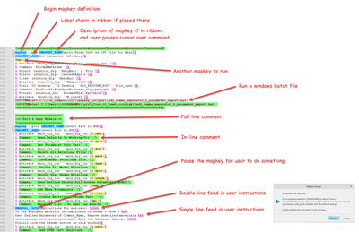

I've created several mapkeys lately so I thought I'd share some general tips I learned to write it down for next time. Please share your own tips below to expand the collection.
This was done on Creo 3 M060 but the ideas should hopefully be not specific to that.
Mapkey Writing/Editing Tips
General Tips:
  • Mapkeys often break when upgrading between Creo Versions (Creo 3 vs Creo 1) but they can save you a lot of time in the year or two between versions.
  • Open the mapkey menu by searching for Mapkeys in the upper right. Also, if someone knows how find the Mapkey menu behind when its behind other Creo Windows, please share.
  • Record commands from the RMB or the Quick Access Toolbar to eliminate extra Mapkey lines that just moves around Creo for no reason. Most commands can be launched without being on a specific interface tab.
  • Mapkeys skip any commands they cannot execute. This lets users add in some logic to close menus that sometime popup or delete items if that would cause an error (e.g. view4dxf view gets deleted if it exists to always allow view4dxf view to get added without throwing an error).
  • When editing mapkey text, always create a backup or copy of the original code so you can copy and paste back in as needed. I usually keep Notepad open to copy and paste code into before changing mapkeys.

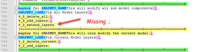

  • As far as I know, mapkeys cannot have comment lines except at the start and cannot have blank lines. Please share if someone has a way to do this.
  • Mapkeys seem to have a minimum and maximum number of characters per line. I usually just visually compare to other mapkey lines to make sure it’ll work. Someone might know the exact limits.
  • Every line except the last line of a mapkey needs to end with a \
  • I like to record mapkeys and then save just that specific mapkey as a text file to my desktop to copy into my actual config.pro. You can give it a relevant name to find it easier like pdf.pro. This will save only the mapkey you have selected into a text file.

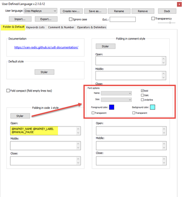

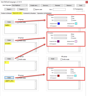

  1. Use Notepad++ for extra capability
  2. Add a custom language to Notepad++ with Mapkey syntax for color coding...HUGE HELP!https://community.ptc.com/t5/System-Administration/Notepad-User-Defined-Language-files-for-Creo-Parametric-and-Pro/m-p/451745

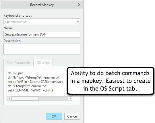

There are sentence in the mapkeys like ”@SYSTEMdel sw.pro\n\ dir /b *.pic>\%temp\%\\filename.txt\n\ set /p VAR1=<\%temp\%\\filename.txt\n\ del \%temp\%\\filename.txt\n\ ”, the commands “set” “del” “dir” and all the sentences,are they Batch commands which usually used in “*.bat” files?
April 23, 2020
In a mapkey you can call batch commands - which is awesome! They get a little difficult to read/write in Notepad because you have to use a \ to 'break' before any odd characters so I like to create the batch/mapkey text via the Mapkey OS script tab. Then I can save to be able to copy/paste the mapkey appropriate text as needed - even in the middle of a mapkey.
The batch command above results in this code below with the \ added to break/escape as needed. \n or \n\ between lines.

You can have a batch command in the middle of a mapkey:
mapkey(continued) ~ Activate `UITools Msg Dialog Future` `no`;\
mapkey(continued) @SYSTEMif not exist C:\\Users\\Public\\Documents\\Creo_BOM_Export \
mapkey(continued) md C:\\Users\\Public\\Documents\\Creo_BOM_Export\n\
mapkey(continued) cd C:\\Users\\Public\\Documents\\Creo_BOM_Export\n\
mapkey(continued) del *.bom*\n\
mapkey(continued) del *.csv*\n\
mapkey(continued) cd C:\\Users\\Public\\Documents\n\
mapkey(continued) del *.bom*;\
mapkey(continued) ~ Command `ProCmdInfoBom`;\

18-Opal
September 13, 2021
LOL!  Easy mistake! I did that early on in my mapkey days too! 🙂  If you use the config.pro formatting file in Notepad++ that is mentioned on this community it will help avoid visual mistakes because it won't be color-coded correctly!
