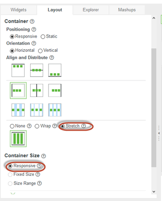

One idea is to make the container that has Collection as responsive, Strech.
Select in Explorer tab the container, go to Layout tab and select Strech:
Please let me know if this is making a difference or not.

You will find here attached a Thing with the "LabelingWOFake" property and its DataShape to fill the Collection widget. I tried the Stretch but it doesn't work. This is really tricky due to the fact is not from the widget itself but into a repeated cell.
