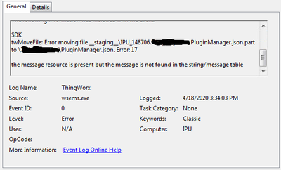

Failed to transfer a file to a virtual directory
Thingworx WSEMS process is running as LocalSystem user, the target folder is accessible, but it is failed to move a file in Thingworx staging folder into the designated folder due to Error 17.
Does anyone know what the error means? Any help would be greatly appreciated!

Can you please attach complete EMS logs by putting the logger level in DEBUG/TRACE in config.json ?It's difficult to crack this from this screenshot .
you can also put verbose= true in ws_connection segment of config.json along with the above setting .

I have just had a chance to duplicate it. However, the TRACE log is not actually explaining what happened.
[DEBUG] 2020-06-05 01:37:22,779 serviceHandler: Handling service MoveFile for thing IPU_100346 locally
[DEBUG] 2020-06-05 01:37:22,782 SDK: getRealPath: Real path for IPU_100346:__staging__\IPU_100346.Folder1.zk.bat.part\ = r:\Build\Thingworx.MicroServer\sendfolder\IPU_100346.Folder1.zk.bat.part
[DEBUG] 2020-06-05 01:37:22,785 SDK: getRealPath: Real path for IPU_100346:\Folder1\zk.bat\ = c:\Folder1\zk.bat
[DEBUG] 2020-06-05 01:37:22,787 SDK: getRealPath: Real path for IPU_100346:__staging__\IPU_100346.Folder1.zk.bat.part\ = r:\Build\Thingworx.MicroServer\sendfolder\IPU_100346.Folder1.zk.bat.part
[TRACE] 2020-06-05 01:37:22,787 SDK: twFileManager_GetOpenFile: Looking for tid: NA, realpath: r:\Build\Thingworx.MicroServer\sendfolder\IPU_100346.Folder1.zk.bat.part.
[TRACE] 2020-06-05 01:37:22,788 SDK: twFileManager_GetOpenFile: Compare to tid: d4851164-6d93-4ca5-ab6e-284ca2d15207, realpath: r:\Build\Thingworx.MicroServer\sendfolder\IPU_100346.Folder1.zk.bat.part.
[TRACE] 2020-06-05 01:37:22,789 SDK: twFileManager_GetOpenFile: Found Open file r:\Build\Thingworx.MicroServer\sendfolder\IPU_100346.Folder1.zk.bat.part\
[TRACE] 2020-06-05 01:37:22,790 SDK: twFileManager_GetOpenFile: Returning r:\Build\Thingworx.MicroServer\sendfolder\IPU_100346.Folder1.zk.bat.part
[DEBUG] 2020-06-05 01:37:22,792 SDK: twMoveFile: Moving file __staging__\IPU_100346.Folder1.zk.bat.part to \Folder1\zk.bat
[ERROR] 2020-06-05 01:37:22,793 SDK: twMoveFile: Error moving file __staging__\IPU_100346.Folder1.zk.bat.part to \Folder1\zk.bat. Error: 17
