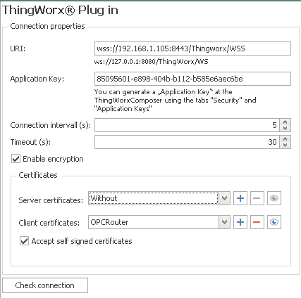

Hello All,
I'm using OPC Router software to connect to Thingworx.

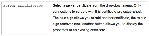

In the configuration session of OPC router, The CA certificate of thingworx is required.
who can help me with this problem?
Thanks and Best Regards.
Best answer by raluca_edu
I don't know if it will work for you, but whenever I need Thingworx certificate I am just exporting it from the browser.
I am opening Thingworx Composer in browser and near https there is an option to see the certificate. If you open that window, you can also save/export it (.cer file).
Hope it helps,
Raluca Edu
