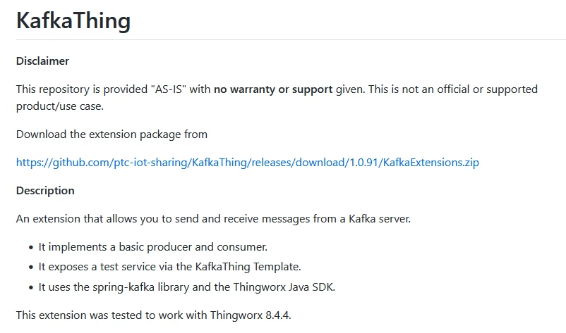

2. KafkaThing extension: https://github.com/ptc-iot-sharing/KafkaThing
Quote: "This extension demonstrates the ability to send/receive messages from a Kafka broker using Thingworx".

Thank you Vladimir. I would test the extension with customer next week and to see if it could be a sample to help them developing their own extension.
