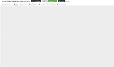

Thingworx Composer mashup design tab is empty
  • September 12, 2024
  • 841 views
Can not edit mashup, the design tab is empty, but I can view the mashup, please help
Best answer by Velkumar
Hi @CZ_10399607
Please check this post - Solved: Design tab while creating Mashup is coming blank. - PTC Community
/VR
Velkumar19-TanzaniteAnswer
September 12, 2024
Hi @CZ_10399607
/VR
7-Bedrock
September 12, 2024
Thanks, it was solved after I re-deploy thingworx, it seems some files were missed in thingworx folder
