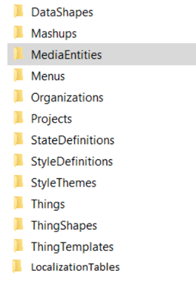

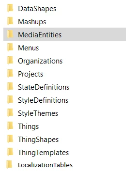

Also, how can we in a good way deploy the localization tokens? Can we in some way export them as "source control" entities?
Is it even possible to put them together with other source control entities folders?
Something like this:
I think it's not really possible though.

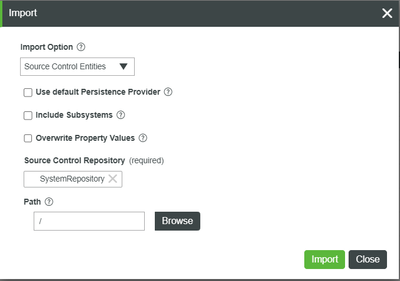

Then I tried using the import from source control entities;
Which seems to have worked fine as my token was imported successfully.
So I guess it would probably work with having the "LocalizationTables" folder in your GIT if you wanted to import everything at once.
