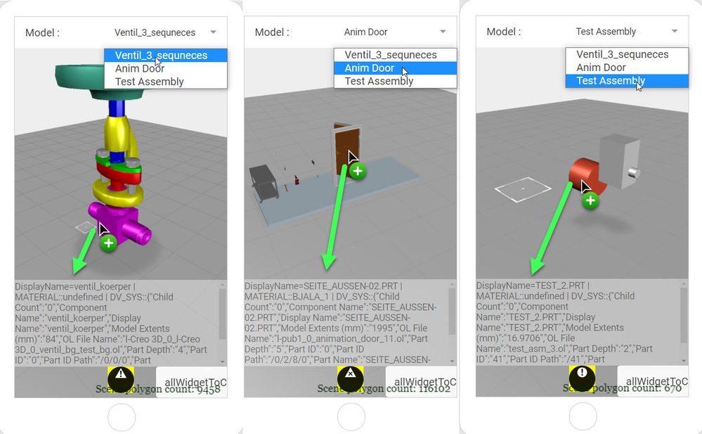

Thanks for the feedback. So seems to be clear now.
I tested the issue according your description. So I created a project with 3 different models where I can change the model via list widget. I used a javascript to synchronize. The userpick should call a query function to receive the properties.- it will write specific component properties to a textArea widget.
So used general query :

All tests are ok and the functionality was working according to the spec. So, I was not able to reproduce an issue with this project. I will attach my test project here, so possibly you can check what are the differences to your workflow. Please, let me know if you could find something. Thanks!

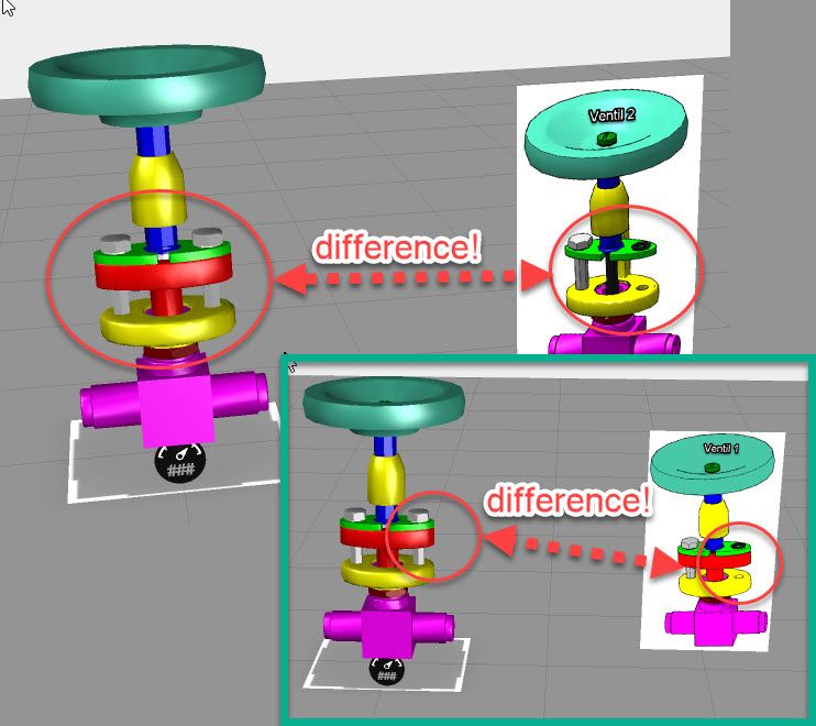

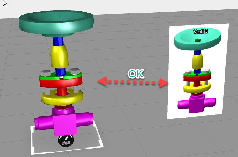

I tested today more detailed the issue and I think to understand the reason why this occurs. Let consider the following setting ventil1, ventil2 and ventil3 (pictures)
this is the original geometry Ventil 3 - so it is displayed OK. But for the another models Ventil 1 and Ventil 2 we have then:
So we can see that the display is not correct! So I think this is the issue what you reported right?

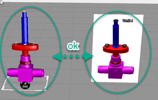

But let look on this version named Ventil 4.

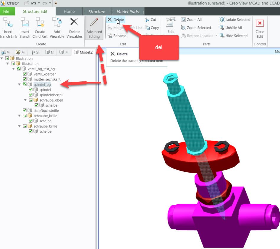

What is there the difference. I used here the edit structure mode form Creo View MCAD to remove the components. And I think this should be the correct workflows.
In this case the behavior work as expected. OK the issue what you described here is also not OK but I think this is something I could report to R&D

- the one workaround could be to use the Creo View MCAD and to edit the structure /advance edit:
where you can remove physically the components form the assembly.
But using the same model many times with different names is not really efficient workflow. Better I think if you define a different step, where you could blank, move or change color etc. form different components. In this case the both issues (wrong display and flipping of to zero world coordinate position) will not occur. So then you can select a different steps and simple call the step via script. Example of such script:
